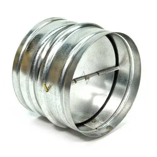

Your fans apparently don't have built-in dampers on their outlets, so you'd need to either add some to each inlet branch of the Y such as the one below or what James pictured, or remove the Y and run a second line to the outside.
Metal backdraft damper
