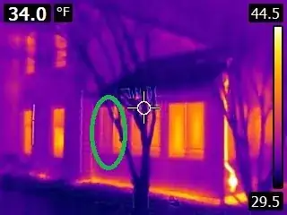

What you really need to check are the thermal characteristics of the existing windows. Here is a thermal image taken during the winter of a house with double-glazed Anderson windows:
Thermal image of windows during winter
All of the windows except the one circled in green are over 20 years old. The thermal image shows that when it's freezing outside they're radiating a decent amount of heat back out.
So what's the deal with that one window that is as well insulated as the walls of the house? That was broken and replaced two years ago. It looks exactly the same as the other windows, but it has a modern seal and is filled with heat-rejecting gas. So it vastly reduces the amount of heat that radiates through the window.
If your windows might be under warranty, it could be worth taking a thermal image to see if any are leaking. Otherwise, replacing them with low-E windows will be quite expensive.
