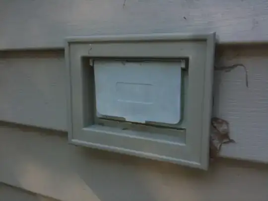

The vinyl-siding manufacturers make special attachments for mounting receptacle boxes, with trim rings to seal against the siding. The attachments are the same or similar to what is used for railings and faucets:
Attachment for outside outlet box

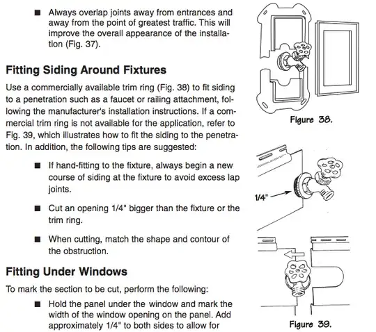

For small fixtures, it is also possible to just cut a hole for it in the regular siding (and presumably seal with silicone), as shown in the following facsimile from the Vinyl Siding Installation Manual:
Do not simply screw the box through the siding as below; it will be very flimsy.

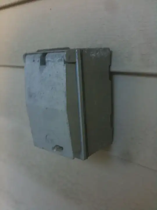

They sell outdoor boxes that you could use
http://www.homedepot.com/catalog/productImages/145/84/843644b0-8a4f-417e-bba0-b4762fc1c6a2_145.jpg
Which you could add different waterproof covers to
Waterproof cover
I would add silicon or some other sealant to the back of the box when you mount it. These can be secured right to the sheeting behind the siding.

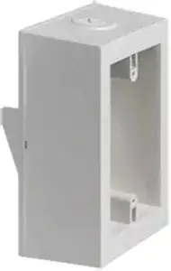

Arlington Fittings makes an electrical box and or special adapter for siding.
Siding Box
While the box picture makes the mounting self evident, here's a specification sheet and here's an installation video. I think to purchase you would have to get through an electrical wholesaler. Usually we are supposed to give you a good description of how to use the suggested products, but I think the links supplied does a better job.
