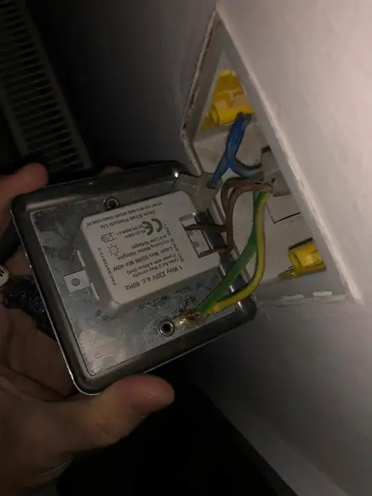

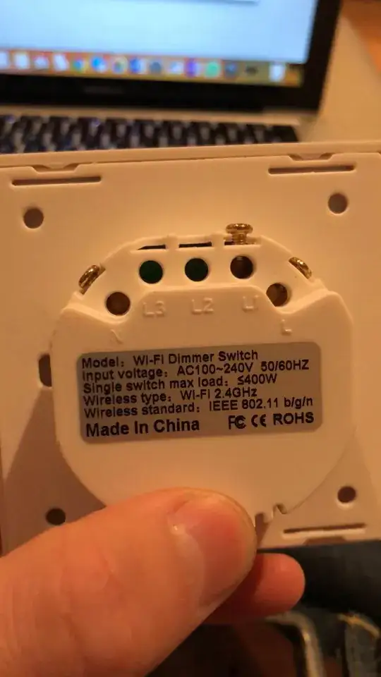

I've just bought a wifi switch and was wondering if somebody could tell me which wire goes to which please? I'm thinking the following?
L = Live (Brown) L1 = Arrow over tilde?? N = Blue (Neutral) Earth = Wrapped up
Thank you
Current Varilight dimmer switch: current switch
To new wifi switch: new switch
Put the two blues into the N connector
The browns go into L and L1, but you have to get them the right way round.
one of the browns goes to the lamp and the other comes from the supply (you will probably need to check for voltage to determine which is from the supply)
The supply brown goes into L and the lamp brouwn into L1
join the earth wires with an approved joiner. over here earths need two screw joiner while other conductors don't, so you probably shouldn't use that joiner that came off the blue wires.

Brown from main to L, brown from light to L1 blue to N: take a 4cm piece of blu wire and pigtail it to other blues, PE connect together the two PE with another wire nut because your new dimmer is class II and don't need the Protective Earth.
If you don't have a wire-nut just put the two blues together into the N place and recycle the nut you have for the PEs.
