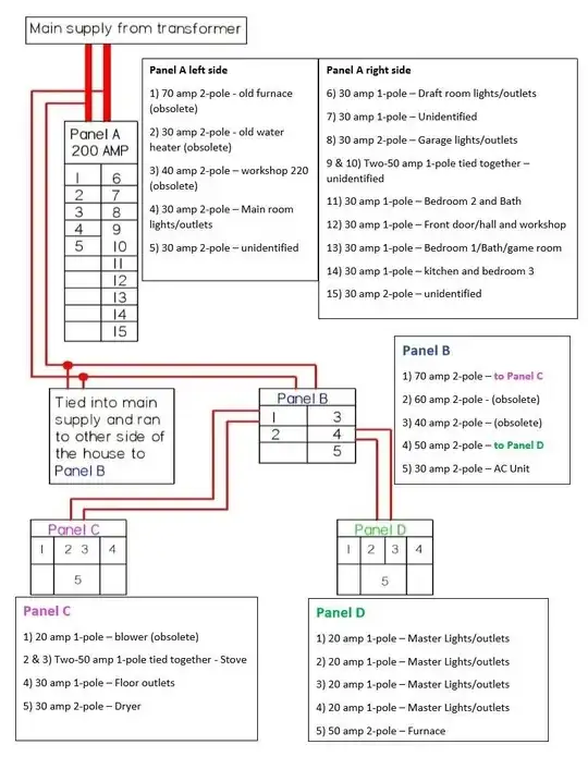

So my home was built in 1960 and 15-20 years later another room was added on. There are panel boxes everywhere ha. I have mapped it all out and isolated almost everything. Anything that is unidentified must not be important or no longer existing because nothing seems to lose power when I flip these breakers off.
The big question…
I have in my possession this electric tankless water heater:
https://www.ecosmartus.com/product/ecosmart-ECO-27-27-kW-Electric-Tankless-Water-Heater
It states that it has an amperage draw of 113amps and at the panel box It will need to have (3) independent 40 amp 2-pole breakers.
You will see in my layout that on Panel A left side I have a 70amp, 30amp, and 40amp breaker that are now obsolete. Can I use those 3 spots to accommodate the new heater?
From my understanding the amperage specifications for an appliance are normally 20% higher than what it actually draws and that most appliances may draw that amount at the initial start up but after that draw much less to maintain operation. I am having difficulty getting a straight answer out of technical support though.
Will I be pushing my limits?
Thanks for your help! Corbin
Well, to simplify the maze somewhat, you have all the usual loads of an all-electric house.
  • 50A furnace
  • 50A range
  • 30A air conditioning pack
  • 30A dryer
  • Eleven 120V branch circuits, some MWBC, many on 30A breakers (WTH?)
Obviously we can oversubscribe this somewhat, e.g. You're not likely to run heater and A/C at the same time.
The fine art of panel subscription is not a core skill for me, but hopefully this summary will make it easier for someone else.
That panel, though

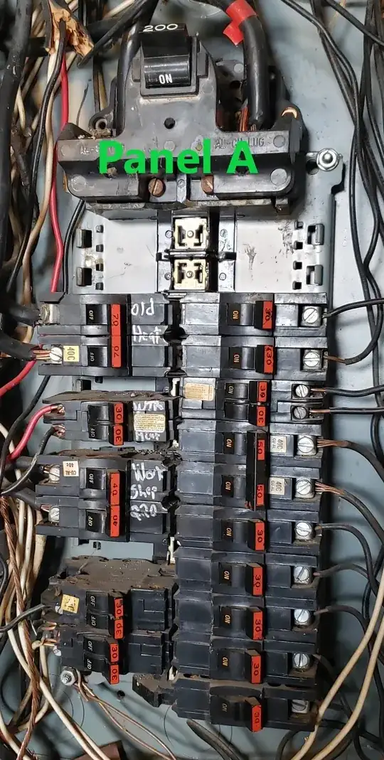

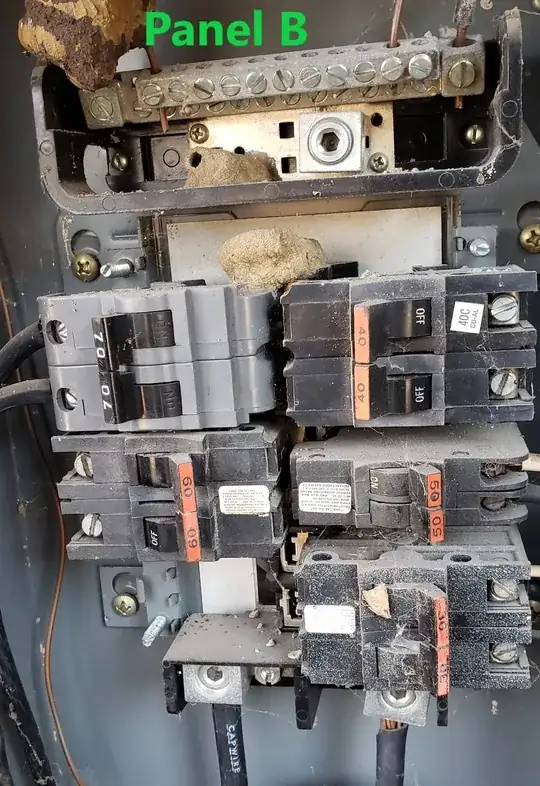

While we're here, we gotta talk about that panel. First, panel B top-tapping panel A before the main breaker is very dangerous unless there is another main breaker before this. The meter is not a fuse, and there are no fuses between the transformer and main breaker. This is considered acceptable for a very short hop from the meter to the main, however, in your case this totally unfused feeder crosses your whole house. Nothing prevents a short in the cable, or in this panel, or summed loads on this panel, from setting that cable on fire.

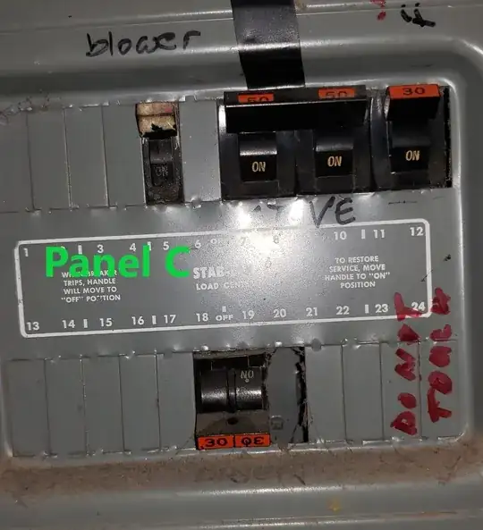

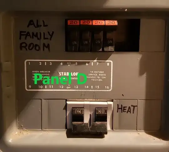

Second, all 4 panels are Federal Pacific "StabLok". It has serious issues with panel fires due to bus defects, and unreliable trip. When feasible, all four should go.
The three subs will be straightforward to DIY, the main will be more troublesome unless there's an outside main breaker. I would DIY install a 200A main service panel right next to it as a subpanel, reuse that 70A breaker to feed it, and move all the 120V circuits out of the main into the new sub. Then bring in an electrician to cut it over to be the new main.
I see many branch circuits on 30A breakers. Those should be 15 or 20 depending on wire gauge.
Gaps in the panel covers should be patched so curious fingers can't touch buses, except finding either breakers or blanks to cover those spots will be a pain.

The first order of business here is to rip every last ounce of Fire Protection Eliminated hardware out of your house and replace it with reputable panels and breakers, starting ASAP with the main panel here, as it simply cannot be relied upon to function.
I would start with a minimum of a 42-space, 200A, main breaker panel as the basis for this setup to provide plenty of space for Arc Fault breakers as well as expansion room, with a 54-space or 60-space panel preferable if space and budget allow. The feed to panel B should be rerouted to make it a proper subpanel of panel A at this point as well. Note that this work will definitely require help from the electric utility to pull the meter/shut power off to your house, and may require you to hire a professional, depending on local codes.
Once you're done with that, you can then replace the other panels at a bit more of a comfortable pace and in a more comfortable fashion as well. I would recommend 24-space if not 30-space, 125A, main lug panels as suitable replacements for panels B, C, and D, space permitting (panel B certainly can be replaced this way, while panels C and D may have to be smaller if there isn't a full-width stud bay there to fit the panel into).
Furthermore, while the breakers for major hardware seem to be correctly sized, the breakers for many of the branch circuits are improperly sized and cannot be used as guidance when selecting replacement branch breakers. This means that you will have to look at the size of the wiring on each branch circuit and use it as your guide when deciding between a 15A and a 20A branch breaker for these circuits.
Also, you may notice breaker trips after you do this due to the combination of improper breaker sizing to begin with and the noted tendency of FPE breakers to not do their one and only job. In that case, you will need to pull additional branch circuits and/or redistribute loads in order to stop the breaker tripping.

Wow! Well written question. I took a look at the installation pdf from the website. Looks like 3 runs of 8 awg/2 conductor cables(plus grounds) between panel A and the unit. My big,big concern that I see which is a big, big safety concern is that panel B is tapped off before the main breaker. That means that that wire has no protection. Big bang potential if you get my drift. Next suggestion is all the obsolete breakers and cables need to be removed from the panels. That is another potential hazzard. Then install as per instructions and area electrical codes. It turns on the necessary resistive heaters based on the flow rate. It is not an inductive load which have start-up currents.
