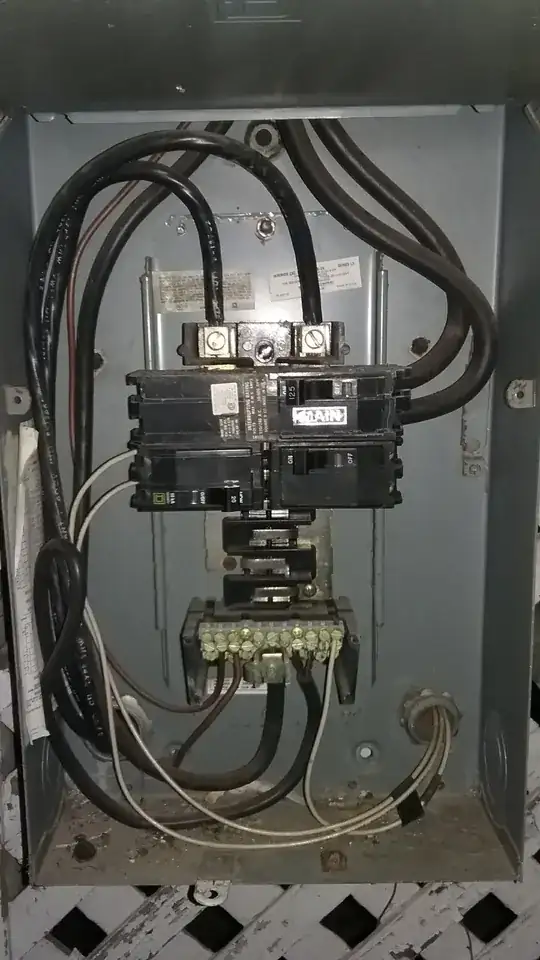

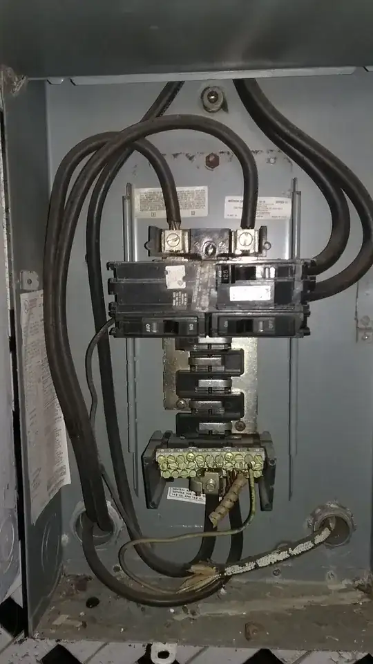

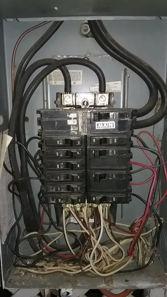

This is a follow up to a question I asked recently about a subpanel that was not wired properly. I'm working on an extremely bizarre situation with the electrical system of an old house that predates electricity and originally had knob and tube. There are lots of issues with it, but this one is about the service.
This house has a 200 amp service that comes in via an overhead drop line. This will be a bit difficult to expain, and I apologize, but I do not have any more photos at the moment than are posted here, but I am trying my best. The electric meter is then connected to two adjacent meter boxes to the left with what I'm pretty sure are metal bars, not fuses, across the terminals. All three of these boxes each subsequently feed a 125 amp panel located directly below (I'll call these the main panels to avoid confusion) and each of these panels also further feed a subpanel (including the one I asked about in my previous question). There is no main shut off for the entire system or the subpanels fed by the main panels located directly below the meter boxes. Instead, the shutoff breakers in the main panels are located on the branch circuit bus, and the service wires to the subpanels are wired to the main bus, where the service wires feeding the main panels should come in. So, to put it in Layman's terms, there is no shutoff for the entire system or the subpanels; just the three main panels.
I have never heard of a situation like this before and have no idea why it would have been wired this way. Is this a unique situation here? I was thinking of just taking out the three panels and two extra meter boxes and replacing with a 200 amp panel with shutoff breakers for each subpanel, as well as moving all the additional circuits in the three main panels here. I guess I could just get a 200 amp disconnect box for the entire system, though, and rewire the main panels to include a shutoff for the subpanels. But I'm not sure that would be consistent with code. Here are the three main panels, as they are located from right to left. In each of these panels, the two hots connected to the main terminals actually service a subpanel, while the service wires for each of these panels are connected to the 125 amp breakers on the top. The meter boxes are located directly above the panels. Note that I am aware that there are lots of other problems with these panels that I didn't mention, and plan to fix them too.

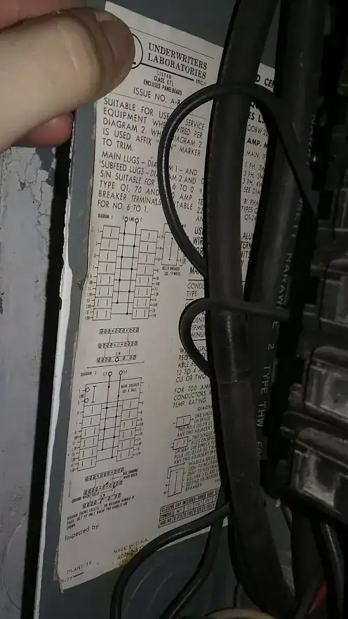

EDIT: Here is a photo of one of the labels. enter image description here

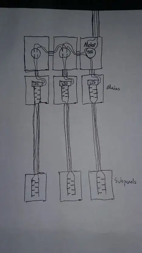

EDIT: Here is a sketch of the layout of the system. Note that I have omitted the neutrals and grounds for simplicity's sake. The subpanels are also not located anywhere near the meter boxes and mains; they are included for explanation purposes. I was also unable to provide a photo of the entire setup due to the fact that I am away from this location at the present time. enter image description here

What you are seeing here is an electrical system that was originally built-out for a separately metered triplex (or a duplex with commons/"house" loads) that has then been converted, along with the building, to single-family residential duty. Originally, there were separate meters in all three meter sockets, and each meter needed its own set of panels in order to keep tenants' loads from getting mixed up, which'd violate NEC 210.25:

As a result of this, you now have a single-family house with three sets of panels in it, all with their own main breakers. This is fine, at least as of the 2017 code (albeit not in the 2020 NEC), due to what is called the "rule of six" or "six throw rule" given in NEC 230.71(A), paragraph 1:

Someone was lazy, and probably created a Code vio in the process of being lazy
However, when your house was converted to a single-family dwelling, whoever did the retrofit took the lazy way out. Instead of ripping out the metering hardware and replacing it with a single meter socket, they left the existing hardware intact and rewired/jumpered it for use with a single meter. This creates an issue, though, as you're most likely overloading the remaining meter socket by pulling the full rating of your utility service through it. This is because while you have a 200A service, the individual meter bases are likely only rated for 125A.
Fixing this issue will require converting this mess to use a single-position, 200A meter main. The good news is your utility does not seem to be picky, as their service requirements permit either ring-type or ringless meter mounting for residential services, 200A and below. (They require lever bypasses for larger or commercial services, which forces those to use ringless meter sockets, but that's not a concern for your situation.)
However, there are three pieces of bad news here. The first issue is that a single meter must be between 5' and 6' from grade level, so that it can be read & serviced without the use of a ladder. Worse yet, the service mast is on the right-hand side of this all, which is quite constraining as many combination overhead/underground meter-mains have their utility wireway on the left, meaning customer wires can't be routed out that side of the box. Finally, any changes to this arrangement will mean cleaning the whole thing up, since your utility forbids both double-lugging of meter sockets and the use of metering cabinets as junction boxes.
Given the physical constraints involved, our options for converting this mess to a single main breaker configuration are severely limited by available hardware, and to a lesser extent by space issues. However, there are still a couple of paths available to us if we do not wish to rip out all the hardware here and replace it, as the existing QO panels still appear to be mostly usable once the grounding and bonding is corrected.
Tap-dancing our way around these constraints
While replacing the existing "200A" meter-socket with a meter-main that has a 200A socket/main breaker and three 125A feeder-breakers in it seems like the most obvious way to fix this issue, the difficulty with that is that there isn't enough space above the right-hand panel to fit a full-sized meter-loadcenter combination without putting the meter well above the 6' maximum your utility permits for single meters.
This doesn't mean that we can't swap a 200A meter-main in for that socket while leaving the existing panels largely untouched, though. What we can do is take advantage of the NEC's feeder tap rules to use a 200A meter-main breaker combination to feed the 3 125A panels without having to mount 125A breakers in the meter-main. This allows us to use a smaller meter-main, and also gives us more flexibility as to what hardware layouts are available to us.
In particular, Square-D makes a suitable meter-main in the CQRA200 (one can also use a CM200S or RC200S with a QOM2200VH field-fitted, although the CQRA200 is a cheaper/easier-to-find solution). This part is a 200A, ring-style, single-breaker meter-main with enough neutral terminations for our 3 neutrals as well as the grounding electrode conductor to the meter base, and more importantly, it puts the breaker on the left and the meter on the right, unlike most other meter-mains and meter-loadcenters which have the meter on top or on the left. (There are some underground-only units with the meter on the bottom, but we can ignore these here since you have overhead service.) This replaces the right-most meter-base, where the existing 200A meter is located.
Now that we have overcurrent protection and metering handled, it's time to invoke the feeder tap rules in NEC 240.21(B), which is what allows us to connect 3 125A feeder wires to a 200A breaker without providing overcurrent protection at the point of origin. In order to do this, though, we have a few constraints we have to follow:
