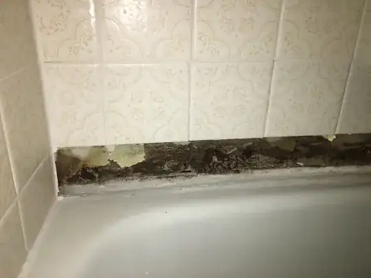

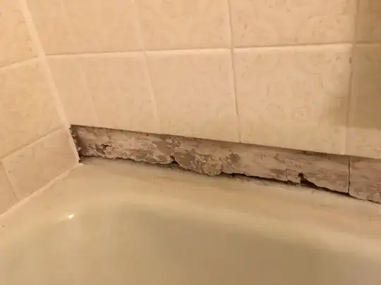

I set out to repair cracked grout at the top of a course of tiles on the wall immediately above my bathtub. After scraping out all the damaged grout I discovered that the only other thing holding the tiles in place was the caulking between them and the bathtub itself. I removed the tiles and found water-damaged drywall -- not cement board -- behind them. Each individual tile had been attached directly to the drywall with globs of a brown substance which I think is construction adhesive (it's definitely not mortar). The water damage caused the drywall paper to disintegrate, so the glue no longer had anything to hold them to.
Bathtub surrounded by tiled walls on three sides. The lowest course of tiles on one wall has been removed, revealing damaged drywall behind them. There is a soap holder glued to the tiles immediately above the removed strip. A boxy machine sits in the tub; this is a dehumidifier. Fig. 1 Bathtub with the lowest course of wall tiles removed, showing damaged drywall behind.
All of the rest of the grouting and caulking is in good condition, and the tiles one course up are still firmly attached to the wall; they don't wiggle at all when I push or pull on their bottom edge. I think this means the water damage doesn't extend upward from the crack very much.

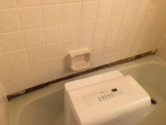

After removing all of the ruined drywall paper, allowing the gypsum itself to dry out for 12 hours with a dehumidifier running full blast right next to the wall, and then lightly scrubbing the surface with a dry brush, it looks like the gypsum itself isn't completely ruined. It's cracked, chunks are missing at the bottom, and many of the nailheads are rusted out, but it seems to be fairly solid overall still.
Close-up of damaged drywall immediately after removing tiles and most of the drywall paper.  The gypsum is covered with some sort of brown deposit.  Scraps of drywall paper are visible. Fig. 2 Close-up of damaged drywall immediately after removing tiles and most of the drywall paper.
Another close-up of the same stretch of damaged drywall, after removing all the drywall paper, allowing the gypsum to dry out for 12 hours, and then brushing off the brown deposit.  The board is cracked and pitted especially near the bottom but might not be completely ruined. Fig. 3 The same stretch of damaged drywall after drying for 12 hours and then cleaning the surface.

The 2nd picture is the most concerning. You have abundant and uniform mold growth. Meaning the other two walls have it too but also I have a feeling you can keep pulling tiles off and go up and you will see it uniform there too. It is really concerning because just eyeballing the shower I don't see any glaring grout or caulking issues - it looks pretty damn good actually. What does this mean? It means you have a persistent water issue that you have not resolved. If you want a cheap/temporary solution by a used shower kit (fiberglass insert) and surround your tiles. Or just big sheets of plastic and caulk the corners.
But you have some major mold and there is an unknown water issue.

Black mould is still very present on the drywall from what we can see on the "after" pictures. I have refinished bathtubs and replaced tiles for over 10 years. My experience tells me that if you have mould you cannot clean it on the surface. Secondly you surely have more mould elsewhere around the tub. I tried to fix a few but soon realized that this "plaster" sollution was not the way to go. Any time I had such a situation I would refuse to take on the work if a complete fix was not undertaken. "Inhaling mould fragments or spores can inflame the airways, causing nasal congestion, wheezing, chest tightness, coughing and throat irritation. Prolonged exposure to high levels of indoor dampness can reduce lung function and cause chronic health problems such as asthma.Nov 1, 2015"
