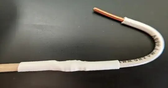

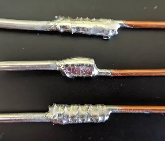

As I prepare to remedy my parent's 1965 home's aluminum wiring I have investigated Copalum and Alumicon. Copalum appears to be unavailable. I've tried a few Alumicon connectors but they take a lot of space in the box and basically add more connection points to fail. Now I'm trying soldering copper pigtails to the aluminum wire. Of course the right flux (Superior 1260) and solder (SN100C) are needed, but the results look excellent. Here are some of my practice samples going from 12 gauge aluminum to 14 gauge copper: enter image description here Before soldering I wrapped the connection with AWG 40 copper wire to hold it together during soldering and to add strength. Once covered with heat shrink tubing the wire seems for all the world to just be a copper wire. enter image description here It takes essentially no space in the box and is far stronger than the aluminum wire itself. A previous thread indicates that direct aluminum to copper splices are not allowed under NEC (at least for new construction), but that is what Copalum does and it is a recommended fix. Also, previous threads indicate the connection must be solid before soldering, so I could twist the wires together first, but the twisting adds a fair amount of space and frankly the aluminum wire is a bit fragile. Yes, it takes a while to solder, but I've got time and I feel far more secure about this than leaving the aluminum alone (which I've had to repair multiple times). The question is really what will happen when the home must be sold? Is this going to be too foreign to the home inspector? Does anyone see any other real issues? Thanks!

A lap-soldered joint like that is good enough for low-voltage low-current low-risk electronics. But it has never been approved for The Big Stuff, and in fact, is unprecedented.
There was a standard for soldering "back in the day"; and it coarsely resembles the Western Union splice. If you dismantle any old Knob-n-Tube that was soldered, it looks like that. Note also that splices had fairly complex insulation: first a layer (by which I mean, 3-6 layers) of cloth-tar "friction tape", with the ending tied off to prevent unraveling... then as it became available, a layer of conventional plastic tape.
However, a Western Union splice would never be conceived of for a dissimilar-metal copper-aluminum splice.
Now I note that your soldering looks pretty nice on the copper side, but the aluminum side doesn't look too happy. So I don't think this would work as a Western Union splice either.
Your judgment of "what I'm doing is no different than a Copalum splice" might get challenged by the manufacturer. It certainly is different. These look like a sophomoric attempt to apply Adafruit tier electronics skills to a very serious problem that's had 30 years of attention from an army of PhD's. If it was anything like this easy, it would have been developed into a solution and added to Code.
What you have there, with the solder-to-aluminum, is akin to a cold solder joint. You've enveloped the aluminum but that is all. You are not bonding to it. Next, corrosion will set in.
