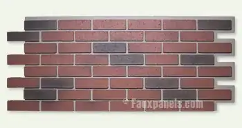

Faux Brick Veneer
If you're looking for cheap and fast, you'll want to look at faux brick veneer. This is typically a sheet material made from plastics, which is molded and colored to to look like brick.
This is very easy to install, goes up fast, and is cheap-ish. Though it tends to look just as cheap as it is, so it may not be suited to your tastes.

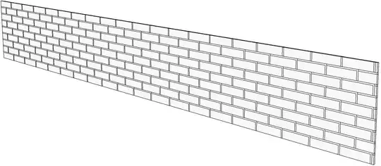

Real Brick Wall
A 14' x 2' wall made from real brick, will take about 182 standard size bricks (3/8" joints). At about 6 pounds a brick, this is going to weigh 1092 lbs + the weight of the mortar.
That's a massive amount of weight for your floor structure to support.

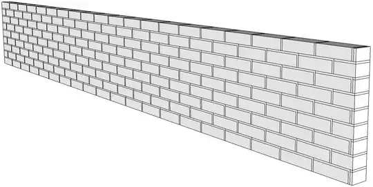

Veneer Brick Wall
Since 1/2" veneer brick only weighs about 0.8 lbs, you can cover the same wall with a fraction of the weight. That same 182 bricks, is only going to weigh about 146 lbs. Not to mention the load will be spread across the wall, not sitting directly on the floor.

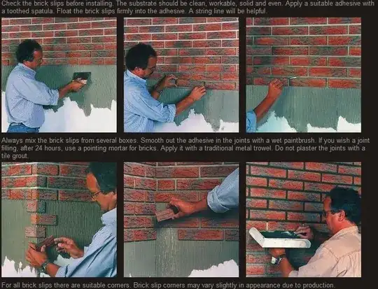

If you don't want to remove your drywall, then putting full sized bricks is not a good idea! Tying into the drywall is also bad idea- it would most likely rip out and will absorb any dampness locked in between all the walls.
There are solution out there where you put look alike bricks that are just a fraction of the weight and there is adhesive that is specially formulated for dry walls too. source
This is very easy, clean and one of the cheaper options giving you a very good imitation of real bricks, slate or whatever finish or pattern you are looking for.

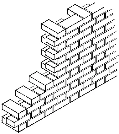

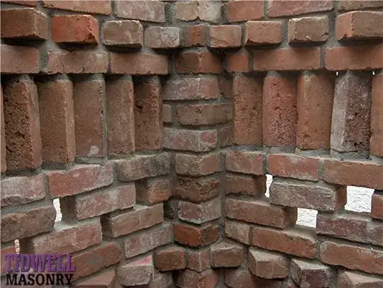

Rip the drywall out and get to your bricks. As long as you are only going to partially build the wall up you can use brick toothing but will require you to remove existing selected bricks from the existing wall and place insert your new bricks into the exists wall at a right angle in several places. Do not removed an entire course at once and do it in steps. several a day over a week - you need the new bricks to rebond properly so they can exert the weight.
Toothing is mostly used for decoration but I have seen it used for adding extra support and bonding to an existing wall too- But doing a full wall needs extra steps.
But you will be placing the bricks at a 90 degree angle making a platform for your new decorative wall.
These can also be used instead of tie ins at various places and heights of the wall. You can choose a pattern of your liking. It is best to put more at the bottom for bearing the load and a constant interval throughout the rest. I have no formula but more it better and too much is worse.
