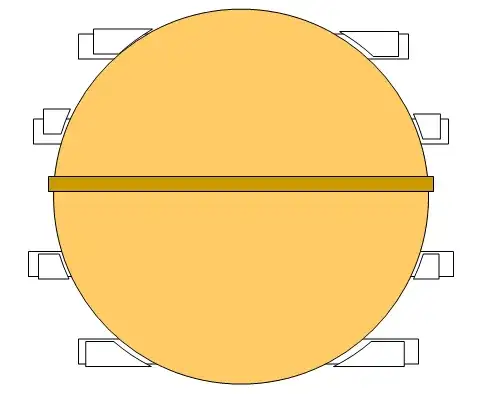

I see some challenge in clamping the round table to get good tight glue joints. You may need to fabricate some jigs to help provide a place to engage your clamps across the width of the table. The sketch below shows one idea of how to do this. Some flat boards about 4 -> 5 inches wide can have some blocks glued and screwed on the ends that will provide a place to engage the clamps.

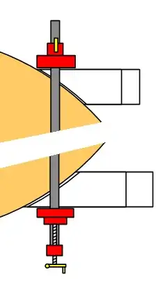

I have shown the blocks somewhat offset from where they would actually be attached to the boards so that you can see the nature of how they would fit to the contour of the table edge. Long bar clamps or pipe clamps would be spanned across the table top at the overhang of these boards as shown in the next picture.
