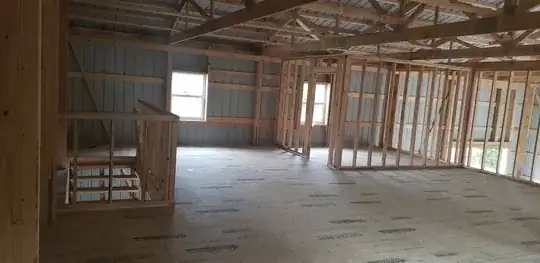

I have a post frame building that was recently constructed where the post and joists have 8 foot on center spacing. The building is 38' x 54' and we had a 2nd floor built on the North end of it which measures 38' x 30. This 2nd floor is to be a framed in and finished "living space". I didn't consider how I was supposed to do a drywall ceiling on the 2nd floor when the trusses are so far apart. I was considering using 1x3" 16' furring strips to span over 2 trusses at 16" on center. I'm afraid that an 8' span will still sag with drywall on it.
My other idea was to put 2x4 8', 16" on center, in between the joists with hangers like these
Would either of these ideas work with what I have? Are there better options?
View of the upper floor

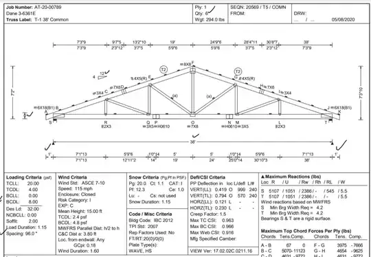

Top of Engineering plan

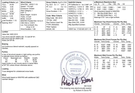

More details of engineering plan

That said, I'm not sure if your truss loading specifications are for bottom-mounted loads? E.g., something like snow load obviously assumes the truss is loaded from the top. So I would double check that detail.
EDIT: Ecnerwal commented that the BCDL=8 PSF is the load rating applicable here.
A sheet of drywall which is 32 sqft weighs around 50 lbs plus you'd need 3 2x4s per sheet, each at ~10 lbs. So the total = 80 lbs / 32 sqft = 2.5 PSF.
So assuming that 8 PSF is accurate you should be well clear.
