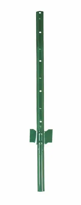

I am a fan of these
steel fence up post
It is from Walmart
This is from walmart but any hardware store will have them. They are cheap. They offer more surface area to the soil that a rebar so they don't tilt - especially if you sink them down to that flat piece on the side. Put a piece of scrap wood on the top when you bang it down with a hammer.
Also they come with holes and clips both which facilitates hanging stuff. Save the rebar for something else.
