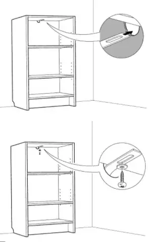

The Billy series of bookcases isn't very deep, so I don't really see it being a tipping hazard. If the crown molding is going to attach to the ceiling, that's already a tip preventer that should hold them in place.
But, if it feels wobbly and you want some extra piece of mind (or if an IKEA representative is reading this), then you can attach it to the wall without any dissasembly.
Billy instructions
The instructions show an L-bracket being used to hold the bookcase to the wall. If you followed the instructions, the bracket gets attached to the wall and then you place the bookcase, but you can easily cut out a hole in the back panel just large enough to fasten the bracket and then attach the bracket to the top of the bookcase. This does leave a hole in a few of the panels, but some creative decorating can easily hide that.
