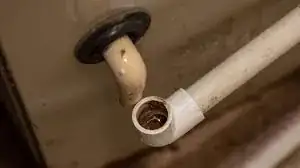

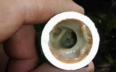

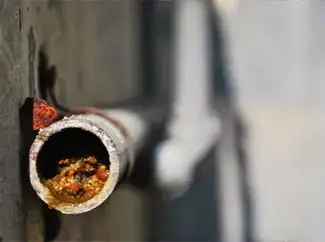

It might be safe today, specifically; it is just condensation after all.
However, I am 99% certain that drain pan material inside A/C coils is not approved for potable water, nor is the PVC drain pipe.
Regardless, I think a quick image search for "clogged condensate line" would tell you that condensate water is reserved for your enemies.
