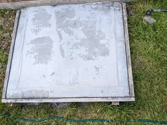

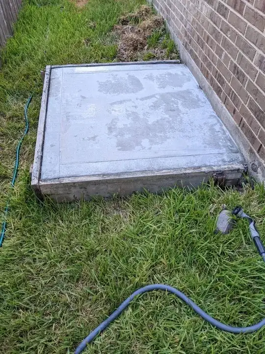

I tried to research this but I could not find any information on the proper process to pour a concrete pad against a house foundation.
There were three holes drilled in the foundation and rebar was inserted. Then concrete was poured. The concrete wet for 4 days to help with strengthening the pad.
location is Houston, TX
Edit: the pad is for a generator
Question:
  1. Should there be an expansion joint between the pad and the house foundation?
  2. Will vibrations of the generator propagating into the house be a problem?

A pad should not be attached to a house foundation at all, unless the pad is sitting on top of an extension of the house foundation complete with footers below frostline - at which point it's not a pad. There's generaly no reason to even abut the house foundation - pads are frequently placed a short distance away from the foundation. They support ancillary equipment that is connected via means that has some flexibility built into it.
A pad floats - it moves with the ground as the ground moves. In any freezing climate, what you have built will be wiggling or flapping up and down (at least one flap per year) while hinging on the point where you've attached it to the house foundation, which will be staying put. That will cause damage to both the pad and foundation.
In a non-freezing climate, you might get away with that, and the house foundation footer might not be much deeper than the pad base. In a freezing climate, this is a disaster that will take about one winter to start happening.
The size of the slab does not need an expansion joint. If the slab was a 10'X10 then perhaps maybe, if larger than that, yes. If it was poured between 2 walls definitely, and no rebar tying it to the wall, defeats the purpose of an expansion joint.
Jack
  • 38,117
  • 66
I don't know what kind of generator you're putting there, but if it vibrates at all, you'll feel it and hear it in the house. I had to mount a large commercial compressor in my workshop on anti-vibration mounts because the vibration when direct mounted to the slab was so objectionable.
For all the reasons stated in this and the other answers and comments, do yourself a favor: get out the sledge hammer and break up the pad, cut the rebar and relocate the forms a few inches away from the foundation. Pour yourself a new pad. This is the only chance you'll have to make it right quite so easily -- without a generator on the pad!

The generator should not be on a pad attached to the house (what you have now).
The generator should not be on a pad next to the house (what others have suggested).
The generator should be far away from the house.
