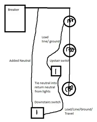

I have some Z-wave light switches that I want to install; below is a link to the diagram for the light switches. Basically I can have all the wiring completed minus the neutral wire for the switch at the bottom of my steps. It will be harder for me to get the neutral from the light than run it in the basement. I have a junction box that is close (4ft compared to 100ft) but it's the living room circuit. Is there anything wrong with tying the light switch that needs the neutral to the living room neutral, based on the wiring is 12/2 and the breaker is the same amperage?
Proposed solution:
Click for larger view

The other answer and the comments are of course correct, but there is a second aspect to it: it won't work.
Actually, it may appear to work, until you try to install a GFCI just about anywhere on either of the two circuits involved.
A GFCI works by comparing the current through the hot wire and the corresponding neutral wire. If those two currents don't match, the GFCI will trip. When you "steal" the neutral from another circuit, the current will go out through one hot wire, but come back through a different neutral.
I actually had an older home where the dishwasher and some kitchen outlet were wired on two different circuits with a shared neutral (that was probably grandfathered in from an earlier era). Trying to bring the kitchen up to code, I was going crazy trying to figure out why the GFCI would trip every time I turned on the dishwasher!

No.
See also: this question, and this question.
If you're in the US, see National Electrical Code (NEC) 300.3(B).
National Electrical Code 2011
ARTICLE 300 Wiring Methods
300.3(B) Conductors of the Same Circuit. All conductors of the same circuit and, where used, the grounded conductor and all equipment grounding conductors and bonding conductors shall be contained within the same raceway, auxiliary gutter, cable tray, cablebus assembly, trench, cable, or cord, unless otherwise permitted in accordance with 300.3(B)(1) through (B)(4).
This other answer explains one reason why this code rule exists.
No, you can't steal a neutral wire from another circuit.
Each neutral wire is the return for the corresponding hot. If you "steal" a neutral from another circuit you run the risk of overloading that neutral wire (overheat, fire risk).
Another issue might arise if the circuit later becomes a GFCI. GFCI measures the current difference between a circuit's hot and neutral. Using another circuit's neutral will make the GFCI detect a current difference and it might trip.
