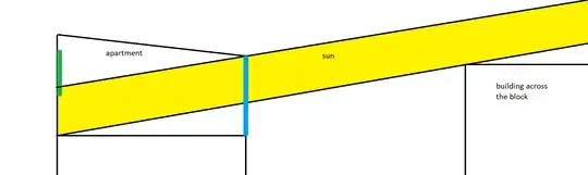

I have tried to draw the scenario in MS paint. The green part on the left is the plant wall and the blue bit on the right is the window (floor-to-ceiling). It's not quite to scale, there is a lot more space between the two buildings, but I think this captures the problem of angles.

I'd consider alternative solutions over mirrors. These also cause glare in your living room area, meaning you might get blinding reflections into your seating area or on the TV.
The angle of the sun varies both during the day and over the year (how much depends on your location/latitude). For that reason, anything reflective should additionally be tracking the sun, to keep said glare on your plants (and out of your eyes). In your case most of the sunlight entering your room was additionally reflected off of nearby buildings, which would make it an even more challenging project.

You would need a two mirror system for your setup. Ideally, you’d need your mirror to dim area ratio to be at least one to one, depending on how far the mirrors are placed. One small mirror won’t do much. Or, you’d need to use a convex mirror for the second one - the kind you sometimes see placed in areas where there’s a blind spot for traffic or corners of store ceilings to monitor for shoplifting.

You need a sort of venetian-blind or jalousie with slats that are strips of mirror.
Because you will be redirecting the sunlight through such a small angle, the slats will need to be quite wide relative to the spaces between them.
I suggest starting with a venetian-blind set twice as high as the window. Take it apart, removing the strings and all the slats.
Cover each slat on one side with reflective mirror film. There are many brands and types of this film; you want cheap and stiff. You will probably not need glue to make the film stick to the slat. Just spray the slat with water and smooth with a squeegee.
Reassemble the blinds with new strings. The slats should be very close together, with the exact distance depending on the slat width and reflection angle. When the slats are at the proper angle to reflect the sunset onto the green wall, if you look at the slats from the center of the green, you should not be able to see outside between them.
