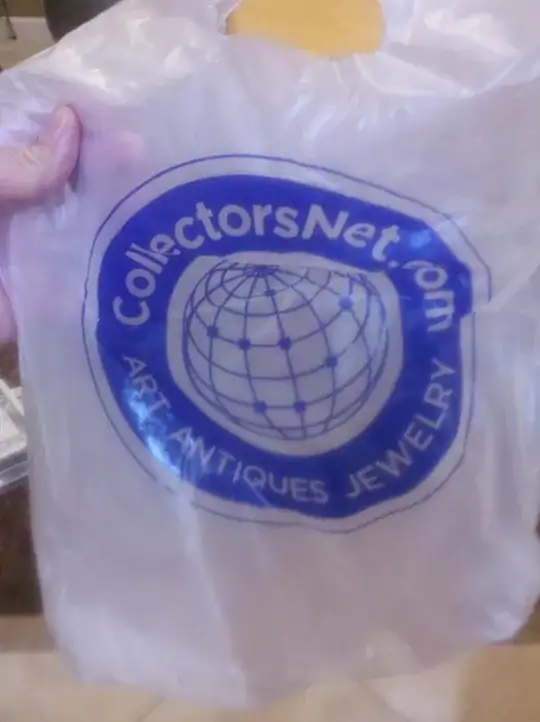

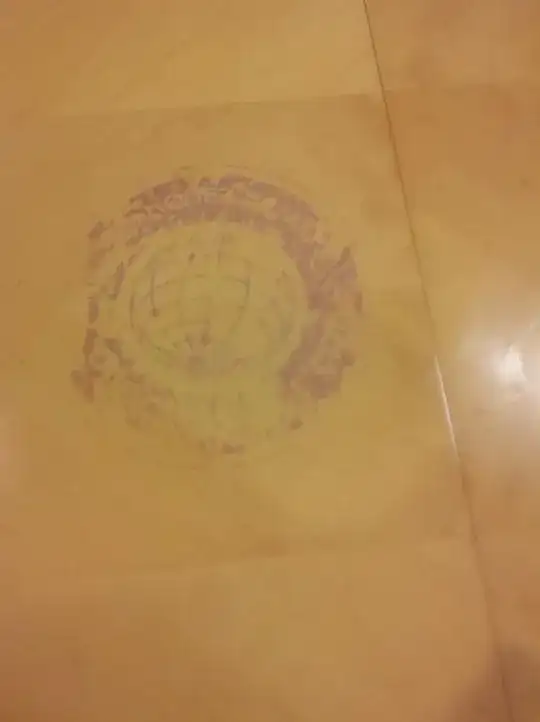

The bag in the photo below stained my wood table (see the photos).
The bag had held some heavy books an was laid face-down on the table. I don't know if this happened through basic time and pressure, or if my cleaning lady applied cleaned the table with some Lemon Pledge, then placed the bag face-down on the newly cleaned tabletop. The table is from Rooms to Go (R2G). Officially per R2G's manufacturer catalog, it is a "cherry" wood with a "clear cherry" finish.
How can I remove this stain without having to refinish the table?

THE BAG, DAMN YOU collectorsnet.com
The stain (originally):
the original stain

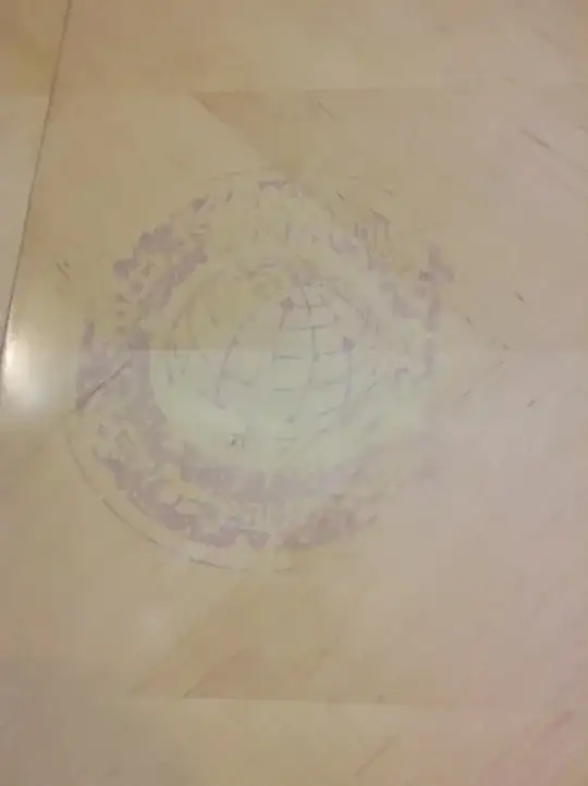

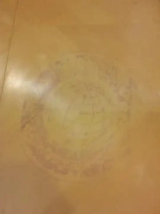

The (upside-down shot of the) stain (post-minwax + elbow grease):
stain post-work
Progress after applying more Minwax and pressure. Doesn't look like much progress, but maybe that's just the lighting.
elbow grease again

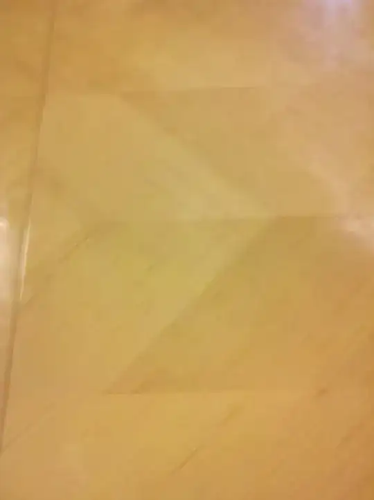

Per the question, I used Minwax until it faded, but it was still quite obvious and visible (close to the last pic in the question post).
Then, taking a page from the "mayo and ashes" tip, I mixed 1-part mayonnaise (Hellman's) to 1-part baking soda (not baking powder; I used Arm & Hammer brand) as a cigarette ashes replacement. I rubbed the mixture along the grain directions using a paper towel and some pressure.
The stain faded, then vanished. The resulting wood is smooth, and considering the baking soda is abrasive, appears unscratched. After wiping off the mayo mix, my table may smell like a turkey sandwich, but it's beautiful again.
Now all I have to do is polish off all the Minwax buildup from my earlier cleaning attempts.
I would never have thought of going with the grain had I not spoken to the lady from Restore and Adore, and had the baking soda idea fell through, I would have gone with the "last resort" 4 0 steel wool with a lot of Minwax applied.
Pic of the repair:
repaired table
