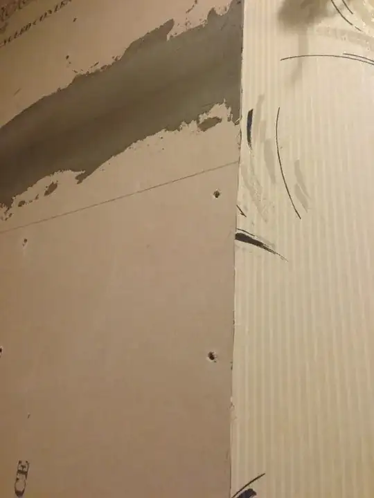

I'm working on a tub surround, which is about to be tiled. And the last piece I need to figure out, is how to transition between finished tile and adjacent wall.
This is how my wall looks right now.
backerboard and drywall meet
Backerboard is 1/4", and drywall is 1/2". With thinset, tile, etc, tile qill be ~1/8" thicker than drywall. I'll be using this edge where the tile ends:
Square edge
What is the best way to facilitate the transition so that I don't have to re-do all the walls in the bathroom? (e.g. something that will not just have a gap there, and will not require reapplying the wallpaper or repainting the whole thing)

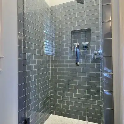

A usual method is to go down the edge of the wall with a surface bullnose, showing a "knife edge" at the corner. This means the tile rolls down to meet the corner.
Another method, if your bullnose has finished bottoms, is to overlap the edge and go "around the corner", having the bullnose round into the outside wall (the wall that has the striped wallpaper) The bullnose will hide the tile edge, putting that grout line facing the side of the entrance.
This photo shows both methods: the left with a flat-on-wall knife edge and the right shows a wrap-around-the corner

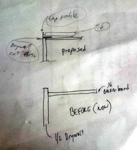

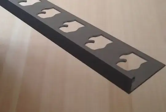

You can use the edge profile pictured, in place of surface bullnose. You would adjust your tile to end short of the corner (equal to the edge thickness of the profile.
Sunday back-of-envelope sketch
In all cases, grout would be filled into the corner/wall junction.

For the sake of completeness, here's the alternative way of accomplishing this: Schluter RENO-TK
Schluter RENO-TK
I'd prefer this one (exactly the offset I have), but unfortunately could not find it anywhere locally, and tile installation was already scheduled.
