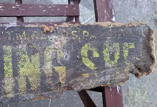

I'm doing some work on an external side doorway/threshold - the house was built in 1912 but had some additions and renovations in at least the '70s, maybe the '50s as well.
As I was cleaning out the area between the door and the exterior concrete steps, I found this loose piece of insulation, along with some old siding and wood scraps. They definitely weren't helping much anymore.

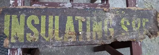

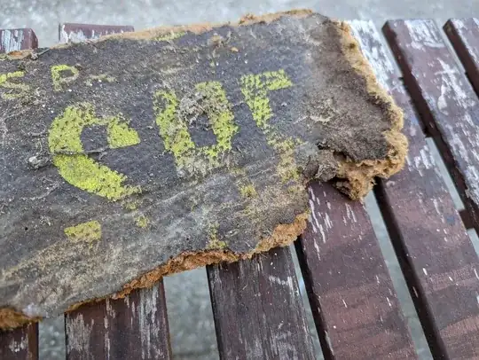

At first I thought it was meant to say INSULATING SHEET, but I think it might be INSULATING SHEATHING. Who knows, maybe it's INSULATING SHEEPDOG. I was also hoping the top text was a brand, but it looks like TM REG US PATENT.
I'm planning on just scrapping it and handling it as minimally as possible. I got curious, though, and tried to see if I could find anything specific about it online, with no luck.
Is this fiberboard sheathing? Are there any precautions I should use besides gloves and a basic dust mask? Is it possible to tell what brand this is?
Picture of partial sheet reading INSULATING SHE
Zoomed in photo of sheet

Doesn't really matter what brand it is. It's fiberboard sheathing--low density in the grand scheme of fiberboard. It was probably installed in the 70s or 50s. It wasn't original. Also known as Buffalo board.
It's a respiratory irritant but isn't likely dangerous. Use a dust mask. Cut it with a circular saw or utility knife.
