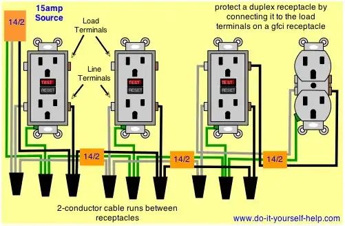

Yes it is accepted and code. The GFCI will only protect what is downstream though.
Also as picture shows you must connect duplex to load for it to be protected. The load will be labeled on the receptacle.
