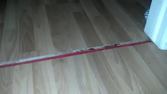

I'm at the point where I want to install some T molding for the transition from our main room to the bedrooms. I just took a look at the directions and they only show screwing the track into the subflooring. Right now I only have the moisture barrier down above the concrete subflooring, so I dont think I can just screw it down. I guess I was thinking I could glue it down, but this would require me to cut into the moisture barrier, which I'm not sure is a good idea either. I'm wondering how I should do this?

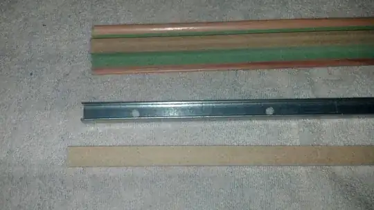

Update - Added picture of T molding pieces if that helps.

  3. Evaluate just where you would place the screws. Looking at your picture I'd say you are going to face screw it into place with brass flat head wood screws from the top. Most likely is a row of screws down the center of the Tee leg. It is also possible that you may place pairs of screws toward the two edges of the Tee leg depending on just how wide the molding actually is.
