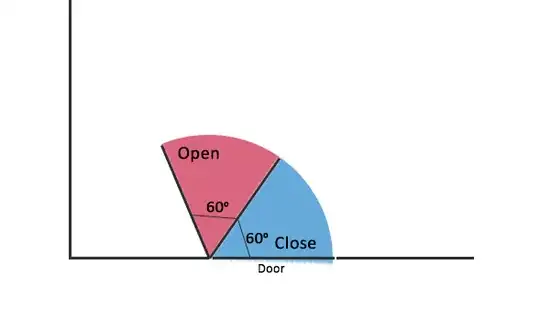

I want to create a mechanism that will force the door to go towards its nearest position (open or closed). Something like this:
When door is left in the open area, it should open (even slowly) and stay there, and the opposite when it is left in the red area. I don't care if it will completely close, but at least be moved to that end.
Door position

Doors tend to open or close automatically not because their hinges are loose or slightly rotated, but because their hinge pins are not plumb. The doors could have been hung that way intentionally (or not), or their walls could have tilted as the house aged.
To have a door move on its own to the nearest open/closed position, the center of mass of the door needs to be at its high point when the door is at threshold for open/close, which in your diagram would be 60 degrees.
Imagine that the dark line at 60 degrees in your drawing is a vertical geometric plane strecthing from floor to ceiling. Both (or all 3 if that is the number) of the hinge pins must be in this plane, with the lower hinge pin 'sticking out' into the room. Thus hung, a free swinging door in a room with no significant air drafts will behave as you desire.

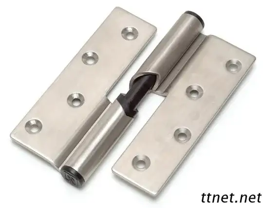

The best approach would be gravity self closing hinges such as these
gravity hinge
These are designed to close the door, regardless of the angle of position.
What you need is the same type of device, but one where the high point of the lower section is at the midpoint of the swing. On one side of the midpoint, the door would swing in, on the other swing out.
As far as I know, no such versions are commercially avaialble. If you are handy and have the tools, you could gring the adjoining faces of such hinges down to create the right "tip point". Note that the door needs to rise and fall a small amount to make this happen.
