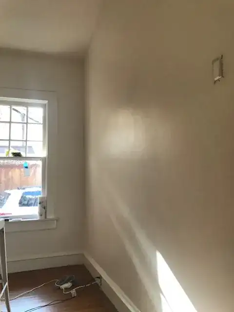

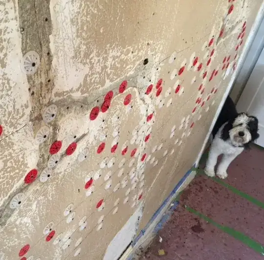

I live in a 100 year old historic home in Texas with plaster walls. I recently changed the texture in my house. I had spider web cracks in all the walls and ceilings that had been previously taped over the decades. I ripped out all the old tape and used Big Wally's plater magic along the cracks to re-attach the plater to the lath for stability. Then I re-taped with fiberglass tape. I scraped the walls to knock off all the high peaks then used the green top Joint compound thinned out with water to smooth the surface. I used the a trowel to smooth the surface and fill in. Then I used the a mudder to apply a nice smooth texture. I kept the ceiling smooth.
This is what it looks like to re-attach the plaster: This is when I was done
This is what it looked like after I ripped out all the old tape and was re-attaching the plaster back to the lath for stability. It's been a year and so far so good!
