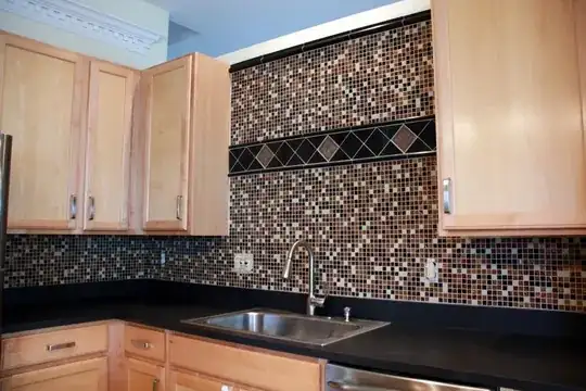

I just finished installing the backsplash in out kitchen using the mosaic glass tiles like you are describing.
alt text
I had no problems with putting the tile directly on the drywall using the usual thinset mortar you would use with ceramic tiles. I used a 1/8 in throwel with the little/thin tiles and the whole sheet of tile would attach pretty easy.
I think that whichever material you chose for the backing will work fine. If you can patch up and sand down the drywall to fix the imperfections, that should work also.
Once you are done grouting make sure to seal the grout since the tile will be exposed to the water.
