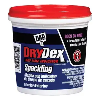

You want spackle. It sticks, it doesn't shrink, and it can be sanded flush. For more detail, see this awesome article that turned me on to the technique: http://www.thejoyofmoldings.com/when-to-use-spackling-and-when-to-use-caulk-moldings/
Spackle is probably one of my favorite compounds; it just has so many uses!

The only thing I use is lightweight Spackle. First fill is fast with your finger. In 20 mins clean off the excess with a damp sponge. 15 minutes later put on a second coat to fill any indents. Again, after 20 mins sponge it off very gently. After an hour sand it if needed and it will be perfect. Minor touch up if needed until you get the nack. I have painted miles of trim and you cannot find a nail.

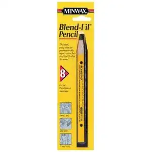

I have always had good luck with pencil fillers such as the one below.
It takes a little practice to get it to fill the hole evenly, but works great once you get the hang of it. It will also never shrink, since nothing is drying.
These come in all sorts of colors: mostly various wood-shades, but also plain colors such as white.

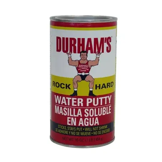

I hardly ever anser my own question and this is the first one I have accepted as the answer to something broad. But there is a clear winner.
Durham's Water Putty. I have no affiliation with the company and really used their products only a few times until this year. This spring I filled in large holes in trim using Durham's (the lock holes). I then started using it for trim nails. I wanted to wait a while to post it as an answer because seasonal highs/lows cause cracking.
Let me sum it up:
Drywall mud = Cracks on surrounding area
Caulk = reduces
Spackle = cracks, not as bad as drywall mud but it also has a lip unless perfectly sanded
wood putty = dries and cracks internally
Durham's = no issues... like using bondo on a car
Only issue with Durham's is sanding is more of a chore. But this is more about practice. Applying it right took me a few times. And then when sanding getting the area wet beforehand if there was a lot of sanding. Definite winner here. Good for this small company - no wonder they are still in business.
