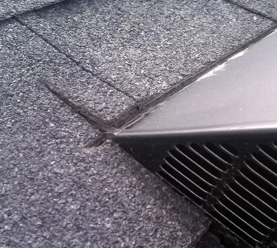

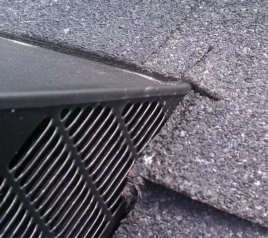

Got a new roof last fall in southeastern Idaho. I didn't notice until this week that the shingles are cut sloppily around most of the vents (see pictures).
Should I coat the bad seams with a can of roof repair/black pitch, or are they normal and I don't need to do anything?

That's not too sloppy. Under that shingle should be the vent, tar paper, and perhaps the top of the next layer of shingles. Since this is right next to your ridge, there won't be much water coming down the roof to this joint, so the risk of any leak around the vent is very small.

What BMitch said, but I would like to see them trimmed back from the vent some. They should not be flush, let alone so tight that they can be propped up like the one in your last pic. Making physical contact w/ the holes in the vent allows an opportunity for water to divert from the shingle into the vent. Cut that back a quarter inch or so, to prevent water transfer and to allow the shingle to lay flat.
