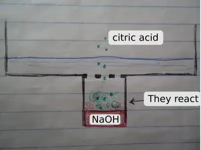

Pouring more water had no effect, so I carefully threw citric acid grains (a weak acid, contained in lemons), hoping the acid would react with the base (NaOH). Initially, the acid reacted with the NaOH (I could see bubbles coming out), but then it stopped completely.

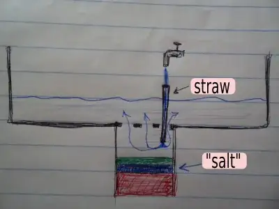

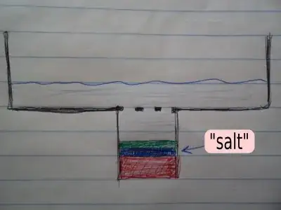

Why it happened

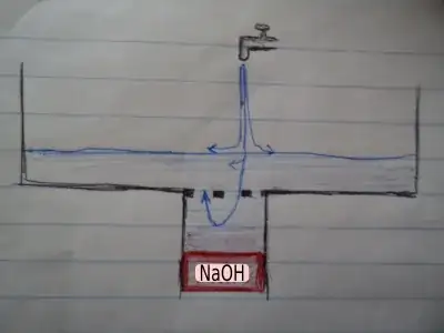

The grid at the entrance of the pipe reduces water flow. My assumption is that the excessive amount of NaOH you used, along with the reduced water flow right after, caused the NaOH to boil instantly the small amount of water that was already present and formed the solid NaOH layer which you described.
Pouring water doesn't work because the water already present, along with the grid, reduces the flow above the NaOH layer, meaning it will dissolve very slowly or perhaps not at all.
When you started throwing the citric acid, it dissolved in the water and reacted with the NaOH, increasing the temperature locally and also creating a sort of "salt", sodium citrate.
Initially it was soluble but as soon as it's concentration increased and the temperature dropped, it's solubility dropped as well, forming a layer of salt (blue color in the figure below), which actually separated your acid and base. This is why they stopped reacting.
Using the straws to guide the water flow directly on those layers will do the trick. The layers will be dissolved within a few minutes.
