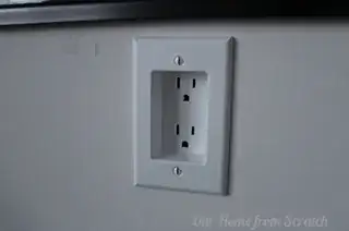

Power
For power, you can add the socket as you described.
recessed power receptacle

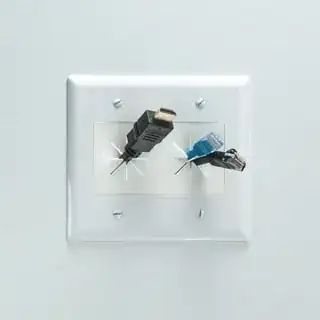

For HDMI/signal/etc low voltage stuff, there are a number of options. Running conduit is the best for future flexibility.

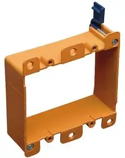

I personally like just having a cable sticking out of the wall, rather than putting connectors behind the TV and requiring a bunch of short patch cables. There's "flexible opening wall plates" that have rubber grommets in them that work very well for this purpose. These work very well with a low-voltage junction box (which basically is a junction box with no back)
wall plate gromets low voltage box

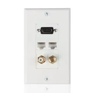

You can terminate the cables near your equipment the same way, or install actual wall plates, depending on your needs. I prefer wall plates with jacks (built-in or keystone) for that situation, because it's neater and allows you to easily disconnect stuff while cleaning/moving/whatever without a bunch of cables hanging out of the wall.
HDMI wall plate

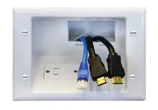

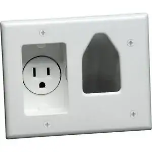

Combined
There are also a number of products that combine both power and low-voltage that work really well behind a TV.
combined power/low voltage recessed power with low-voltage hole

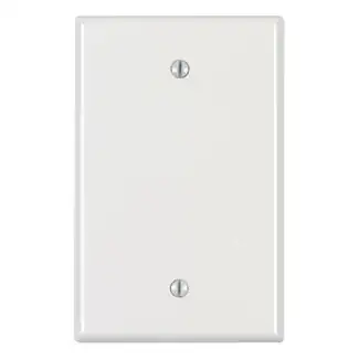

My standard practice is to use a low-voltage "box":
... and a blank cover plate:

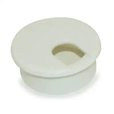

... to which I add a desktop grommet:
It's a bit fiddly, but hot glue works well to secure the grommet to the plate from behind and now you have a robust, high-capacity, good looking conduit for about any cable. There's a good chance someone makes something like this ready to go, but I haven't come across it.

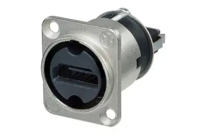

In addition to the other answers, you can get all kinds of sockets including HDMI in a standardized format, these were designed for pro audio applications. Pro audio shops, electronics shops etc. carry them.
Example:
Neutrik HDMI
(this is a feedthrough connector, with HDMI sockets on both sides)
(Edit: removed recommendation to cut and solder an HDMI cable, as that's unlikely to work correctly)
