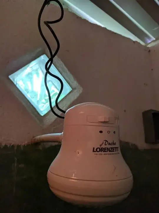

So in the place I'm currently staying, they use an inline hot water heater1. This is a ~5500W, 50A beast2 that replaces the shower head and heats up the water as it comes out. Notably, even 5500W isn't enough to really get the water hot if the flow rate is high, but it's certainly better than nothing.
I noticed that when I turn the water on, the bulb in the bathroom gets brighter. That's the opposite of what I would have normally expected. I whipped out the multimeter, and sure enough when the shower isn't running, I am reading 92V-95V3, but as soon as I turn it on and the shower starts drawing ~30A, the voltage increases to about 107V, which explains the brighter bulbs.
I'm used to a heavy load like a 30A4 either dropping the voltage, on a system with long insufficiently thick wiring runs (or a weak voltage source, like a generator or inverter near its maximum load), or holding steady (a well designed system) - but what could cause a load to significantly increase the system voltage?
Notes: I wasn't able to measure the voltage at the shower head itself - I measure it at an outlet elsewhere in the house. You can't see it in the picture, but the ground wire which comes out of the back of the shower head is simply pigtailed to neutral, which is why you only see two wires coming out of the head - unsafe as hell, but could this also have an effect, e.g., by providing a second return path for current?
Inline Hot Water Heater

This seems like the neutral cable in a split 120-N-120 service is not handling the full current. A small gain in brightness of a lamp on one side of the circuit, when a 30 or 50 A load is applied to the other side, is not unusual, but measure the voltage if it's more than a barely-noticeable increase in brightness. The maximum voltage should be no more than ~127 V.
In the extreme case of a neutral wire breaking (which happened to my service after a tree fell on the entrance cable), the voltage across each half of the circuit becomes 240V split by the resistance for the circuit. E.G. with a 40 A designed load (3 ohms) on one side, and a 1 A designed load (just a 120 W lamp, 120 ohms) on the other side, the actual voltage across the lamp would be ~234 V, and the 40 A water heater would get only ~6V. The lamp would be very bright for a very short while. (In my case, I was lucky -- a few lamp ballasts burned out, but over-voltage protection varistors on outlets blew circuit breakers before a fire started).
DrMoishe Pippik
  • 10,706
If I would have done the math 5500/120 = 45.8 amps. To verify it is a load imbalance causing the problem an amp clamp meter will be needed. You may be able to move breakers around to balance the load on the service. With one leg heavily loaded and the other not loaded an increase in the voltage on the unloaded side is not unusual. Code requires balanced loads but gives no specific percentage that is allowable. This may be almost impossible to fully balance but moving more of the 120v loads that may be in use while the water heater is running will reduce the imbalance and reduce the voltage swing you are observing. I would only try to reduce the imbalance because after the water heater is turned off the imbalance will be on the other leg.
