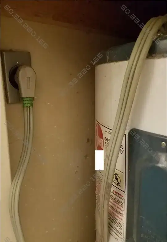

Could you please help me answer the following questions?
1) Will unplugging my water heater from the socket when not in use damage it?
2) Which energy-saving timer will work with my water heater?
Below are details of my water heater.
Company: Rheemglas Standard (Energy Miser)
Water Heater Model #: 0199B54937
Wattage: 240/208 Volts AC ONLY
Upper: 4500/3380
Lower: 4500/3380
Total: 4500/3380
Already Tried: I have already tried contacting Rheem customer support; however, no one has responded to my inquiry yet.
Listed UL Water Heater 786H
EDITED
Temporary picture gallery showing (1) electric water heater plug, (2) air conditioner's stand-alone switch, and (3) air conditioner unit above electric water heater.
Pics added inline enter image description here

Do not plug and unplug that outlet on a daily basis. That is probably a 30A rated receptacle (probably NEMA 6-30 or 14-30) and those are not rated for frequent use. (Most especially the obsolete NEMA 10-30 -- it would be illegal except for the rationale that it is rarely unplugged and is therefore unlikely to fail deadly.)

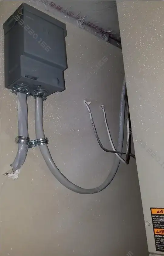

I'm unclear on what the box is, in your second photo. I don't see an operating handle but it's the right size to be an ultra-heavy grade switch. If it controls only the water heater, you can use that to turn it on/off.

Anything you use must be rated for the amperage of the receptacle, wire and breaker, for instance you are not allowed to use 20A-rated gear on a 30A receptacle. Also the device must be UL-listed (or whatever your region's listing authority is) - and it must have a proper enclosure, no dangling devices or exposed terminals. And be properly mounted.
