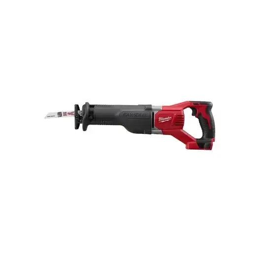

You can use a reciprocating saw (often called by a brandname, Sawzall) recip saw

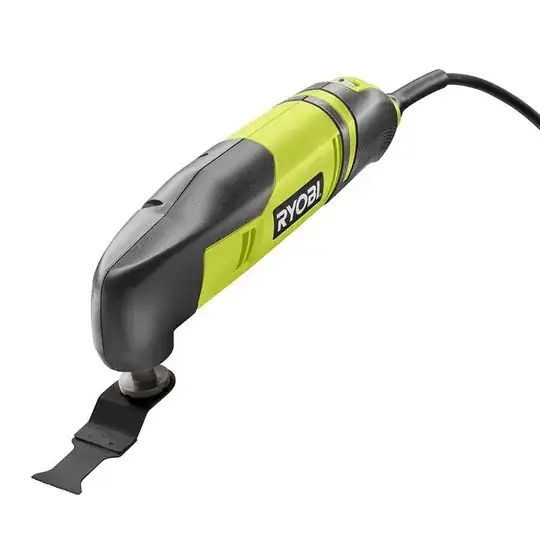

or a multitool multi tool
In either case, you need to use a blade intended for cutting metal. Some blades are combination blades that work in wood or metal. Place the blades between the bottom of the decking and the supporting framing and cut just the screw. The small amount of wood taken out will not matter, but lean the blade toward the wood being discarded.

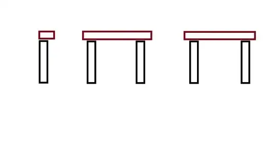

@Bib is absolutely correct in the answer above, but in the grand tradition of skinning a cat multiple ways, here's an alternate approach. I think this would be faster than an oscillating tool and easier than a sawzall. (Though both are great tools to have -- don't let me discourage you there.)
Given that you're not trying to save the deck boards, I'd use a circular saw to rough cut them first, then use a sledge hammer to knock them off the screws. Anything that is awkward for the sledge can usually be removed with a 2' pry bar. If any screws remain, first hit them sideways with a hammer to see if you can break them; otherwise, twist them out with vise grips. (This assumes that you're taking out a large percentage of deck boards... if you're just plucking a few strategically, this advice doesn't apply. However, if a few of your deck boards are bad, it's probably not long before all of your deck boards are bad, so doing everything at once might work well.)
Cutting strategy: if your deck is nearly ground level, then just run the circular saw between each joist. This is a lot like cutting the tree limb that you're sitting on, so care is required as you get to the edge. If the deck is a little higher, (so hard to access from the ground), cut so that you've got walkways of deck boards that bridge two joists. The pattern would look like this: enter image description here
Again, use caution, as you're relying on less and less structure to keep you from tumbling.
