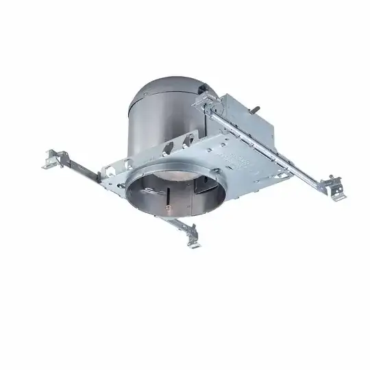

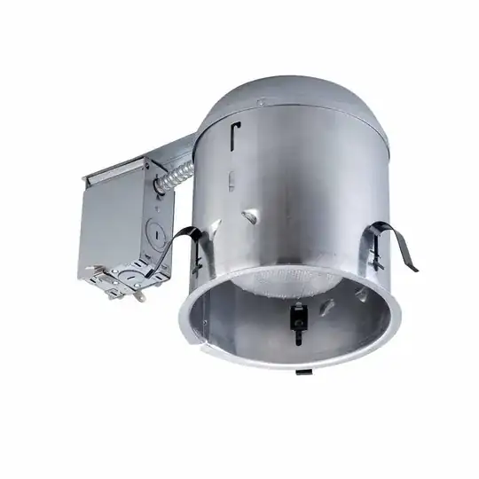

There are 2 types of pot/can light fixtures - remodel cans (sometimes called "cut-in" or "drop-in" cans), and "new construction" cans. I have always seen "new" fixtures used when possible, especially if the framing is open for pulling the wire.
Which kind you chose for this sort of project depends on how you prefer to sheetrock, and what the inspector is going to be happier with. Typically, the inspectors and electricians I've worked with want all the electrical rough-in complete before sheetrock goes up - but neither of category has to worry about cutting the sheetrock correctly as you do. If you use the remodel cans, the inspector may want you to pull (or just leave open) some of them so he can see how the connections are being made.
  • Remodel - inserted into circular holes cut into existing sheetrock
  • New construction - attached to the framing prior to sheetrocking, with circle holes cut in the sheetrock as it's placed.
