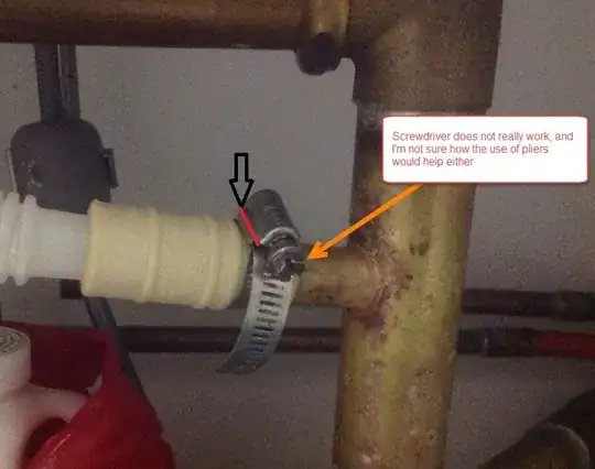

This will come across as a silly question but I cannot open up the hose clamp for my dishwasher's drain tube. I need to unhook/open the tube, clean its head, then reattach. The metal clamp simply won't open, when I use screwdriver, the screw simply won't come out, it just becomes loose in its place but there is no way to take it out. I'm not sure how pliers would help either because I tried pulling the screw out and it didn't work either. enter image description here NOTE: I need to use the same hose , so I cannot break this hose. It's FAR beyond my expertise to change the whole tube, I'm just trying to clean the head to open it up. So I need to be able to reattach it.
Thank you very much for your help.
UPDATE: Sorry for my bad wording: I don't need to reuse/keep the clamp, I just need to keep/maintain the tube/hose because changing it requires taking out the whole dishwasher. My dilemma is cutting the clamp without damaging the hose now.
The END SOLUTION: Lots of great answers, comments and suggestions. I ended up actually forcing (force pulling) the tube/hose, and took it out. Once it was out, it was easy to just slip the shot clamp!

Hose clamps like this are made to clamp, but they are not made to un-clamp so easily - instead, as you have observed, the worm-drive screw tends to un-screw out of its housing when turned anti-clockwise.
The way I loosen the clamp in this situation is to first snug the clamp using the screw - we are not wanting to make the clamp tighter, but simply to get a baseline of the worm-drive screw in its housing. Next, loosen the screw one or two turns, so it is loose, but not falling out of its housing. Finally, and this is why my response is the correct answer, you need to use slip-joint pliers ("water pump pliers", "Channelock pliers") to squeeze the head of the worm-drive screw into its housing, which will have the effect of pushing the clamping band open (instead of pulling it tighter). You will need to repeat this sequence (loosen clamp screw couple of turns, squeeze with pliers) until the clamp is as loose as you like. Note that I have used this method for years on dishwasher hoses such as yours and various hoses under the hoods of my cars and on motorcycles. No chemicals, no hacksaws, just tools & technique. And sincere appreciation to the handyman who showed me this trick when I was a wee lad. :)

One of several things is probably happening:
  1. The clamp has corroded or gunked in place, so you'll have to continue turning the screw until opening force is applied to the grooves cut into the clamp band, popping the band's bond to itself and the pipe.
  2. The screw threads are stripped and not engaging the grooves in the band. In this case, a rotary tool and cutoff wheel are your friend.
This type of clamp utilizes a worm gear. You see the slots in the band? The threads of the screw turn into those slots and move the band in or out tightening or loosening it. The screw is stationary. It cannot be removed. It just spins in place pushing or pulling the band.
You need to "loosen" the screw by turning it left. Using a nut driver or a socket wrench is better than a screwdriver. Eventually, the band will expand enough that it can move freely on the hose.
If that doesn't happen, the worm gear system is probably shot. Whether that's the screw or the actually slots in the band. In that case, your only option is to cut the band and replace the clamp. They are very inexpensive.
Edit: If you decide to cut it, you could get by with a hacksaw but it will be a pain. I have added some markings to your picture. I would cut along the red line. Once cut, you can just bend the screw assembly over out of the way and the clamp will release.
