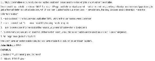

I couldn't find a solid source that says a closet is Required, to make a room a bedroom. It seems to depend more on the agency listing the property, and the mortgage company financing the sale of said property.
The only requirement I could find dealing with bedrooms from the Federal Housing Administration (FHA), was that an emergency exit is required.
enter image descriptionhere
I did find some information that suggests that the Multiple Listing Service (MLS), does require a closet when defining a room as a bedroom.
Source
Your best bet would be to contact a local real estate agent, and ask them if they would list the room as a bedroom.
