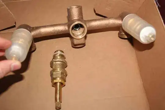

Sounds like the washers/gaskets on the valve have gone bad, you'll have to either replace the washer or the entire valve (if you can find a replacement).
Here is what the valve may have looked like when it was new (just to give you an idea of what you're dealing with).
Removal
  • Turn off the water to the shower faucet using either a local shutoff valve or the main water valve for the house.
  • Turn the shower’s hot and cold water all the way on, to drain leftover water from the pipes.
  • Pry the cap out of the center of the diverter’s handle.
  • Remove the screw in the middle of the handle, and then pull the handle off the faucet.
  • Unscrew the metal sleeve that sits over the valve stem.
  • Insert a Shower Valve Socket Wrench over the valve stem and turn the dirervter anti-clockwise to remove it.
Installation
Installation is the reverse of removal.
  • Insert a Shower Valve Socket Wrench over the valve stem and turn the dirervter clockwise to install it.
  • Screw on the metal sleeve that sits over the valve stem.
  • Push the handle on the faucet, then replace the screw in the middle of the handle.
  • Push the cap into of the center of the diverter’s handle.
  • Turn the shower’s hot and cold water all the way off.
  • Turn on the water to the shower faucet using either a local shutoff valve or the main water valve for the house.
