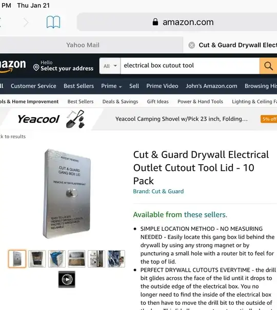

I recently invented a new product called the Cut & Guard Gang Box Lid specifically to protect the wires as well as to simplify the cutout process. It’s an inexpensive simple lid that goes on top of the electrical boxes to protect all the wiring. It also makes it easier to cut around the electrical box with a rotozip because you no longer have to jump the drywall bit from the inside to the outside edge. The lid prevents the drywall bit from plunging into the top of box or from cutting into the box from the sides. Another benefit is that it keeps the box clean from mud and paint. Hence making it easier for you to finish wiring. enter image description here
