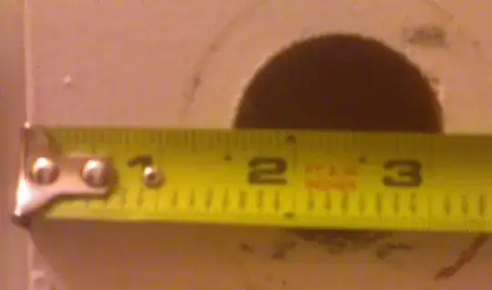

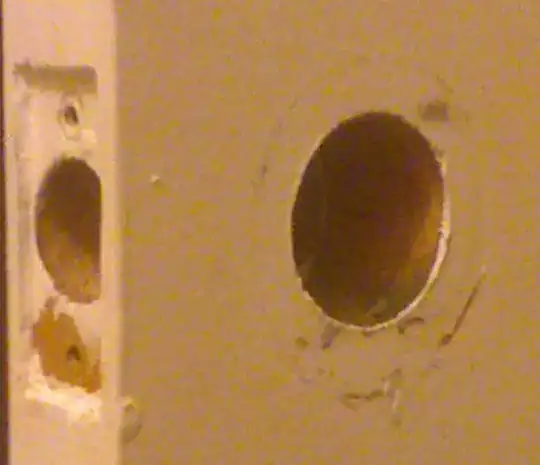

I need to replace the door knob for this interior door:
Door with door knob hole
The door knobs I've found at the stores require a 2⅛ inch hole. Mine is only 1½:
Measuring 1½ door knob hole
Did door knobs used to be smaller? Is there some place I can find a replacement door knob that will fit my door?
If I need to modify the door to fit a modern door knob, will the new hole completely overlap the old? and can I reuse the latch hole?

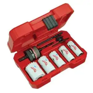

Two other options. If you need to expand the hole with the exact same center, you can get a hole saw kit that uses an arbor with multiple attachable hole saws. Place the larger size hole saw with the smaller size inside of it, and tighten the arbor on both. The smaller hole saw acts as a guide in your existing hole.
For this to work the smaller hole saw must be the same or longer height, as depicted in the picture above. If they are the same length, the thickness of the base of the larger hole saw will cause it to protrude slightly. You can also use a washer to give it more depth as long as you can still secure the bit to the arbor.

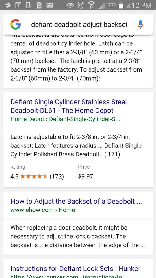

I was in exact same situation replacing a 1970 door lock got a name brand lock and the barrel was protruding while hitting back of knob hole.
Wondered same thing,
it's like my new lock was John Holmes wtf.
Anyways I went back to home Depot there was a $25 Cdn deadbolt Lock called Defiant there , I recall also using one last year at a friend's apetment it's pre configured for the smaller hole and adjusts by spining it to longer hole.
VIOLA no drilling or or Jig headache required.
DEFIANT brand $10-15 USd or $20-$25 Cdn Walmart, Home Depot and Lowes all sell it. Installed that and a pull handle on both sides, last year I simply drilled a hole for old liock above deadbolt which was in existing hole. That way I had a pull without buying anything extra. I may do that here and return gate pull.
Defiant Single Cylinder Stainless Steel Deadbolt DL61 at The Home Depot - Mobile http://www.homedepot.com/p/Defiant-Single-Cylinder-Stainless-Steel-Deadbolt-DL61/100352212
Also Google how to adjust the backseat and your brand of lock. enter image description here
