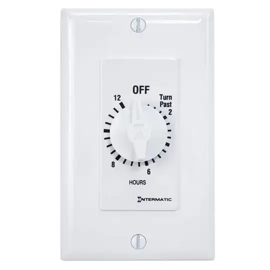

You're probably looking for either a spring-wound timer:
spring-wound timer

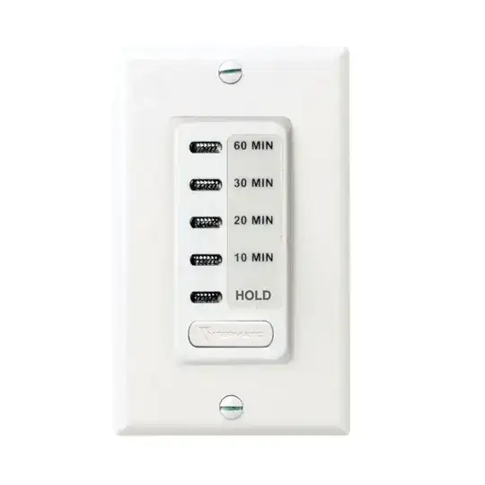

or a (digital) countdown timer:
countdown timer
As @Harper mentioned, you can get them in various time ranges.
