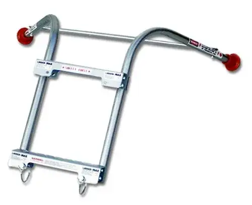

A ladder stabilizer can often help. This is a bracket that attaches to your ladder. It makes the ladder much more stable when leaned against the house. A nice thing about the ladder stabilizer is it lets you lean the ladder on the wall of your house, NOT against the edge of your gutter, possibly causing damage to the gutters.
