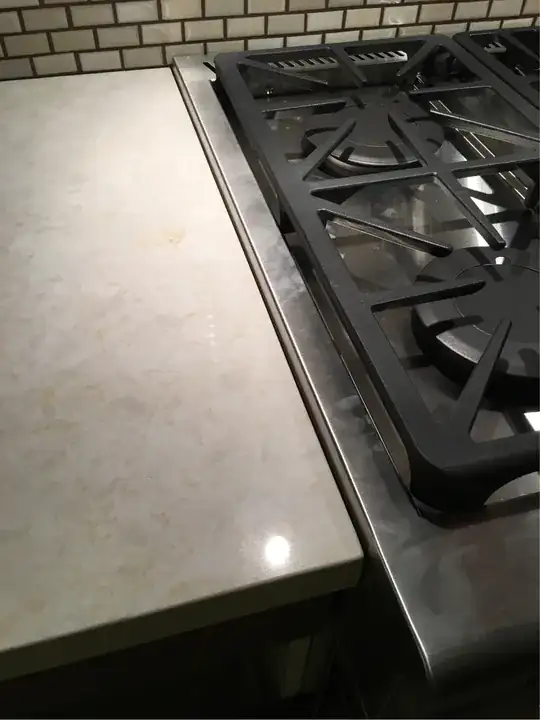

What's the best material to use to seal the gap between my counters and the stove? It's a pretty tight fit but we don't want any crumbs and food bits to get in there.
If we use caulk will it stick to stainless? Will it leave a mark if we decide to remove the caulk?

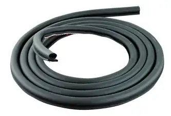

I use foam rubber weather stripping gaskets:
Alternatively, rubber hose works equally as well.
Just buy it in a profile slightly wider than the gap, then tuck it in the gap. Friction will hold it in place. And easy to replace if you ever need to pull the stove out.
