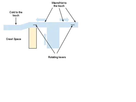

My furnace shoots hot air up to one main exit, then branches to the two sides of my home.
I discovered two hinges, one on each branch, one of which when I rotated it, provided air to one side of my home (as many may expect)
The other, no matter how much I rotate or which angle I rotate the lever, the other side of that ducts remains cold and no air is pushed to the other side of my home.
Is it possible/smart for me, as a new home owner, to try to dissemble the ductwork in the problem area to attempt to free the valve or any possible blockage? One friend of mine told me to cut a hole in the side, use a coat hanger to try to open it, and seal it with duct tape.

I noticed when looking at how I could take the duct off, there are no screws, just tabs. Please see attached picture.

Things are still not working in our home. I tried all different combinations of the two dampers open and close to no avail. I also drilled a hole and used a rod to ensure the left (in the diagram) damper was open which it was. There were no other obstructions in the way.

One other thing to check. In your diagram, the "cold" part is on the left, and you've verified that the damper is not the cause of the problem.
You'll need to check to see what's further to the left of your diagram - air needs an outlet in order to flow, and from your description it doesn't sound like that's happening.
I'd find the first vent attached to the left hand leg, and work back from there to see if something is blocking the airflow. It doesn't sound like there are leaks, because then the left leg would at least be a bit warm.
