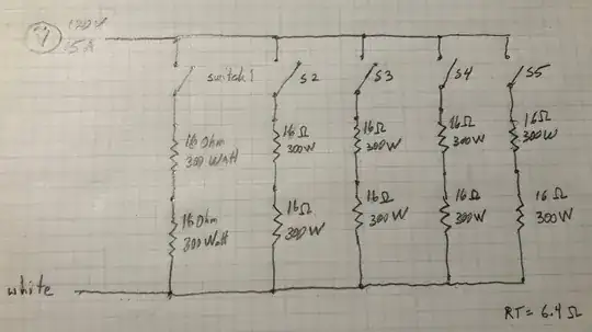

Let's assume the guy with the box was not incompetent or insane and that he had actually devised a reasonably safe means to do this. What would it take? Below, I present a design that should work. I want to emphasize that I have not built this or tested it - this is purely theoretical. If you want to try it, do so at your own risk. I understand the fact that commercially available devices are out there that can identify circuits. Nonetheless, I have often wanted something similar to what was requested here, and the interest in this post tells me I am not alone. So here are my thoughts.
First of all, a couple of electronic principles. Ohms law states that Voltage (V) is the product of Current (I) and Resistance (R), V = I x R. A typical home circuit is supposed to be 120V. The standard circuit breaker is rated for 15 Amps. Using Ohms law, we can rearrange the equation as follows: R = V / I. So, 8 = 120 / 15. This means that an 8 Ohm load would draw 15 amps at 120 Volts. Resistance less that 8 Ohms would draw more than 15 Amps, and should trip the breaker.
Now, don't go out and buy an 8 Ohm resistor from radio shack and hook it up just yet. The other factor we need to consider is power dissipation. Power (Watts) is the product of voltage (Volts) and current (Amperes), Watts = Volts x Amperes. So, at full load, a 120 V, 15 Amp circuit provides up to 1800 Watts of power. This means that, with 8 Ohms of resistance and 120 Volts, the box would need to be capable is dissipating 1800 Watts. The resistors you see on circuit boards are typically something like 0.25 Watts. That won't work.
What we need now is a resistive element capable of dissipating the power. A simple method would be to create a box that has multiple screw-based light bulbs, and to get some high wattage bulbs, and have enough of them connected to exceed 1800 Watts. You could add toggle switches for each bulb, and then switch on one at a time until the current draw was too high and the breaker tripped. The advantage here is that you would be dealing with components normally designed to be powered by 120V, and all the wiring and switching would be standard stuff. The problem is that such a box would be bulky and it is getting harder to find high wattage bulbs. Plus, light bulbs break.
An alternative would be to use wire-wound power resistors. For about $18 each, you can buy power resistors capable of dissipating 300 Watts each. Power is additive, so if we have at least 6 resistors, we could handle 1800 Watts. That being said, it is not a good idea to run things at their limit. So I would design a circuit with at least 8 such resistors, so it could handle 2400 Watts, a reasonable safety factor. Home voltage is often as high as 125 Volts, and the breaker might allow more than 15 Amps to flow before tripping; 2400 Watts gives a safety factor of 33%, so we should be OK.
These resistors come in various values. A 16 Ohm, 300 Watt power resistor would be my choice. Back to basic electronics. In a series circuit, Resistance of the Total circuit (RT) is the sum of each individual resistance: RT = R1 + R2 + ... + Rn. In a parallel circuit, Resistance of the Total circuit (RT) with multiple resistors in parallel (R1, R2, etc.) is calculated by the following equation: 1 / RT = (1 / R1) + (1 / R2) + ... + (1 / Rn). Putting two 16 Ohm resistors in series makes a 32 Ohm resistor. Placing four 32 Ohm resistances in parallel makes a total resistance of 8 Ohms. That should draw 15 Amps and may or may not trip the circuit. Adding a fifth 32 Ohm pathway in parallel makes a total resistance of 6.4 Ohms, which would draw over 18 Amps and should trip the circuit.
So the idea would be to make a box, with a switch for each pathway, that has at least 5 32-Ohm pathways, each capable of dissipating 600 Watts. Switching on the first 4 would draw about 15 Amps from 120 V, switching on the fifth would go over 18 Amps and should trip the breaker. If you wanted to add a sixth, you could also potentially trip a 20 Amp circuit.
Here is a diagram with five pathways.
The resistors would cost you something like $120. The light switches could be standard stuff. You would need to make sure to wire it with wire capable of carrying enough current. Each 32 Ohm pathway would carry 3.75 Amps. Heavy gauge lamp cord would do the trick.
