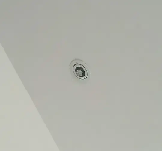

I have gable roof and there are 4 halogen lights on ceilings. If I am sitting upright, it's good but due to the angle of the ceiling, if I move slightly to any direction the light goes directly to my eyes.
Even if I look at my tablet or phone the light reflection hits my eyes. It's very annoying and I searched to find some sort of diffuser but they are only used for light bulbs and halogen lights are flat and screwed inside the wall/ceiling. Any solution that helps is appreciated.
I am looking for something that is also good looking. I don't want to have something like a patch on the ceiling.

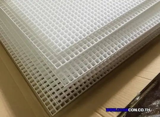

If you are happy with some DIY work - grating type diffusers which have an array of holes each maybe 15mm square, with the array mounted "some distance" below the light surface will provide full illumination downwards with a quite sharp cutoff at an angle.
Adjusting "some distance" and tilting the array will allow you to customise vision lines
Can be known as egg crate louvres - several examples here
One example - many styles exist.

I'm assuming the lights you refer to are in-ceiling recessed (a.k.a. "pot") luminaires using a PAR20 type of halogen lamp. Depending on the manufacturer and model, some of these come in two parts: the basic housing (which contains the electric box and wiring) and the trim (which is the visible portion). You can purchase an alternate trim for these luminaires. If you replace your trim with a gimbal trim, this allows you to swivel the lamp so that it points in a non-objectionable direction. Check out this gimbal trim as an example: https://www.homedepot.ca/en/home/p.flush-gimbal-par20-trim-gloss-white-4-inch-aperture.1000169488.html

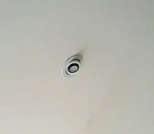

They look to be adjustable on the direction so first step would be to try and change the pointing angle to be less disturbing.
I can not zoom in enough but the first picture looks more like a LED type. If you can confirm the actual model installed then you could add an appropriate dimmer to reduce the strength when desired.
If the lens are spots a switch to flood bulbs would put out a wider light "beam" reducing concentration of light making them more acceptable.
Last they make light shields and diffusers for ceiling cans to help reduce the directed glare.
