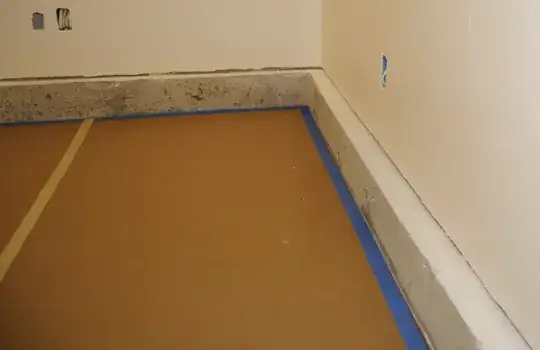

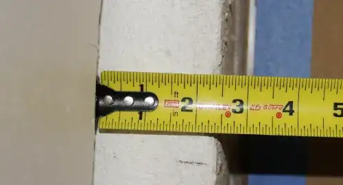

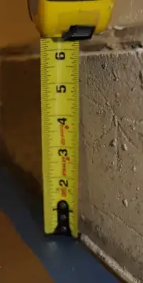

I am finishing a basement room and have a concrete ledge which is part of the foundation. It protrudes into the room about 2.5 inches and is about 6 inches high. This ledge is the result of a particular way of pouring the foundation which results (as I am told) in higher ceilings in the basement, but leaves this rather annoying ledge. (See photos).
Apparently there are multiple ways of working with this type of thing, which I learned from looking at similar homes in my neighborhood: Some people frame the walls inside the ledge completely, effectively shrinking the finished room by that amount; others have framed up to the window sill height and created a shelf in the room at that height.
I've chosen to maximize space in the room and finished the walls above the ledge intending to create an exaggerated baseboard around the concrete ledge. However, exactly how to do that is proving difficult.
First, the concrete thickness (protrusion into the room) is not consistent. It's 2.5 inches in the middle, but is nearly 2.75 at one end and 2.25 at the other. Whatever I cover it with will have to compensate. The height of 6 inches is fairly consistent.
Next the concrete is not smooth, there are many small protrusions which will have to be worked around or removed with a chisel or hammer.
Finally, I'd like to have a small measure of insulation so that the room is isolated from the cold concrete.

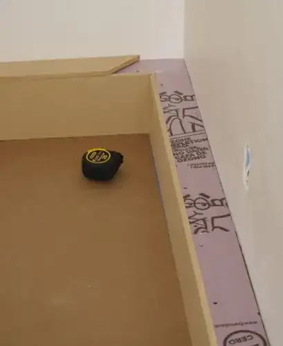

I decided to go with plan "A" and thought I would post an in-progress picture. Thanks for the suggestions and tips.
Concrete Foundation Ledge Ledge 6 Inches High Ledge 2.5 Inches Depth Ledge - In Progress

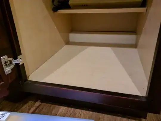

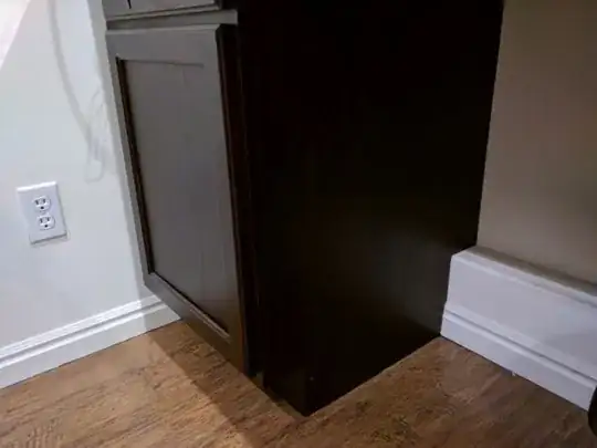

For those interested, here are some pictures several years later. I installed cabinets and notched the bottom/back to install flush with the wall. It protrudes inside the cabinet, but not overly so. Notching was quite a bit of work. The ledge doubles as a footrest. ;)
Cabinet with notched back Inside cabinet showing ledge

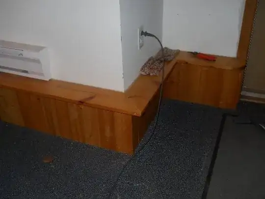

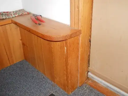

We had an almost identical situation in a former garage that we refinished to be an office. Our contractor suggested this and we liked the result: he installed a piece of wood about an inch out from the concrete, putting insulation between them and keeping the wood a consistent and level height - a little higher than the concrete. I can't remember if it was pink fluffy insulation or spray stuff. Then a shelf about 6 inches out from the wall - nice and level by being a bit up from the concrete and supported by the vertical wood, and there's insulation under the shelf too. The whole thing is a good looking clear pine and is well varnished.
low shelf
Looking from the side gives an idea of the distance from the wall:
side view
The shelf runs around the entire room and is remarkably useful for something so low. It hides all the lumpy bumpy aspects of the concrete and while it's not something you see everywhere, no-one has ever mentioned it so it can't be that unusual.
