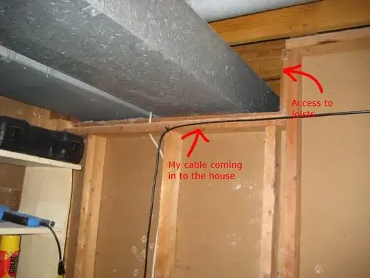

So here's where my cable comes in to the house (wall to the right of this pic out of frame), and where I can easily access the joists:
Access to cable and joists

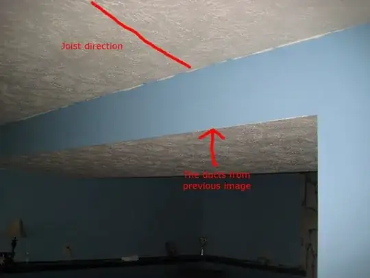

In my living room, here's what those ducts look like. Fortunately the joists run in the direction I'd like to run my cables.
living room, joists and ducts

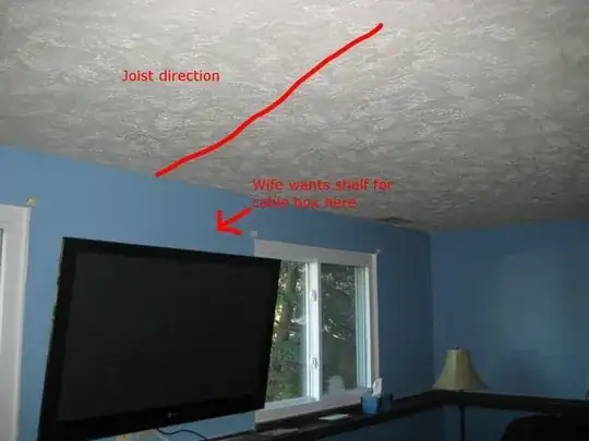

Here's the TV, my wife wants a shelf above it for the cable box, home theater PC, etc. So I need to fish network cable to this spot on the wall. There is a cable outlet there already but I have hunted all over and I cannot find a the other end of the cable. This house was a rats nest of RG-11 wiring when I moved in, and none of it makes any sense. TV

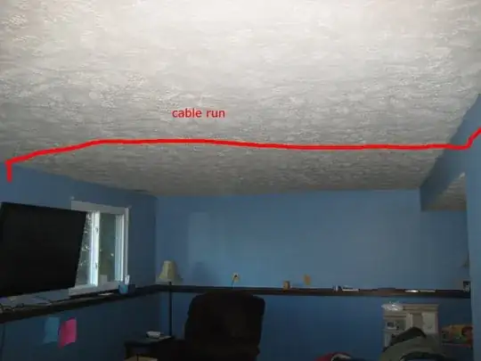

Here is the approximate cable run. cable run
My biggest questions:
  1. how I'm going to get the cable about 4 feet down through that hump in my ceiling and then make a 90% turn.
  2. How to fish it along the ceiling
  3. Am I going to have to cut an access hole in my wall by the TV, then patch the drywall to do what needs done? I can't think of any other way to do it. At least not in a hole the size of a wiring box.

I think I'd look for the outside spliter and run the cable around the outside of the house under the edge of the siding and try to enter as close as possible through the wall behind the TV. If the spliter is indoors, run a line back outdoors and around. BMitch is correct, you will never be able to fish that distance without opening the ceiling, and cutting into the drywall at the top corner. There will be a lot of drywall repair needed, and be very hard to match that textured ceiling, not to mention the mudding and painting in the top corner.

Couple problems I see. First is the textured ceiling. You'll never be able to open that up and patch it without being obvious, the texture is something that just isn't done these days. Second, the exterior wall should have insulation in it, so you'll end up fishing the line through insulation and the vapor barrier.

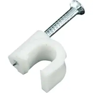

Instead, I'd suggest running the line around the floor if you can get it to a convenient wall anywhere in that room. Use some fasteners to keep the cable at the base of the wall to run it around the room:
cable fastener

Well, here I go potentially disagreeing with some more experienced folks. Assuming you have clearance over the ceiling all the way to the back wall, this is doable with fish tape and a hole in the wall with the tv on it. Get some small conduit (even thin pvc pipe will do), and put a 90 degree angle in the end. In the case of metal conduit you would bend it with some pliers. In the case of PVC pipe you would get threaded parts and screw it together. Run it along the joist. Assuming you have some clearance between the joist and the ceiling you should be able to hit the wall behind the wall with the tv. Now all you need to do is pull the cable down and plug it in.

It looks like you want to put the TV on an exterior wall. If that is the case, my recommendation would be to run the cable on the exterior of the house and just punch through the siding where you want to terminate the cable. You should place a low-voltage rework box at the location of the recepticle. Make sure to use cable clips to keep the wire against the wall.

Also before ever tapping into a ceiling look at what direction your vents are sitting. This will tell you which way your floor joist are running.
