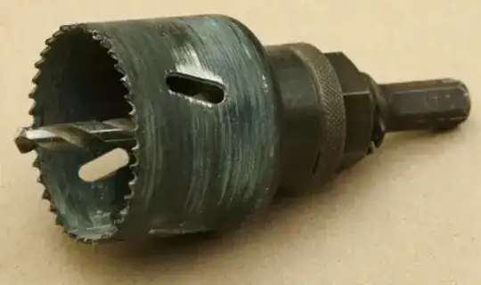

Of course you can, and it's very easy to do.
All you need is an appropriate hole saw.hole saw
Drill from the top down. If you can, hold or clamp a piece of scrap wood under where you are cutting. That will prevent the bottom from splintering.
Then to make it really look nice (and prevent any future splinters) you'll want a desk grommet that slips inside the hole. Make sure you match the size of the hole and your grommet.
