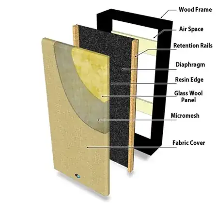

I can't find any data about the size of the particles for fibreglass or mineral wool. One company uses a material called Micromesh but provides no data about it: enter image description here

You would do fine using simple burlap. Given the wavelengths of the signal that must pass through, cotton fibers will pose no problem. They are also considerably smaller than the coarse fibers found in commercial acoustic panels. In fact, any material used as speaker cover would work for your application. Incidentally, fiberglass is a very hard and acoustically very reflective material. You may do better with a panel of dense open cell, soft urethane-based foam; they may be found at a local craft store.
Knob Scratcher
  • 421
If you didn't buy the 703 yet, check out Applegate's cotton acoustic panels. Since cotton is harmless there's no need to cover them plus they're rigid enough to use completely by themselves with no frame.
