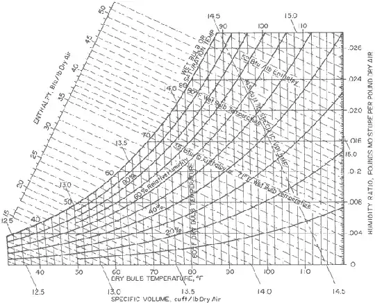

(2) All else being equal, condensation forms on the inside of the windows more rapidly at night because the temperature of the indoor window surface is colder at night. The colder the windows are, the more water will fall out of the air onto the surface of the glass. If you want to know the exact temperature that condensation will start to form, it can be looked up on a psychrometric chart like this one:
Find the intersection of dry bulb temperature and relative humidity, then follow the dashed diagonal enthalpy line intersecting that point left and up to the edge of the curved area on the chart (the line marked “saturation temp”). That is the temperature at which your air will start to deposit condensate on surfaces. As you can see on the chart, cold air with a high RH carries less water in it than warm air with a moderate RH and cold air requires even colder surfaces before the remaining water vapor will condense.
