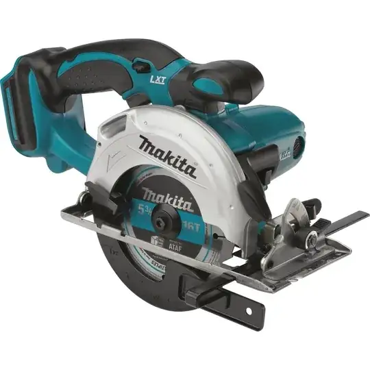

Makita cordless saw
It's lightweight, quiet (non-scary), and powerful enough for most things that you would do with a handsaw -- but will stall somewhat easily if you overload it. Not quite finger safe, but should minimalize risks from kick-back or throwing chunks of wood around. Not having to worry about where your cord is at is a safety benefit as well as a convenience, and most models have a very effective blade brake, so the blade stops moving as soon as you take your finger off the trigger. This is a great safety feature which is still missing from most corded models.
Nothing is 100% safe, but you would almost need to be trying to cut yourself with one of these.
I have used many, but not all brands, and can say that the Makita pictured above has good build quality and excellent ergonomics, which is an underrated safety factor. I'm sure that other manufacturers are also great -- sometimes home improvement stores have demo days where you can "try before you buy". You should see what works best for you; these saws are one of my favorite things for low production, high mobility tasks as opposed to hauling a heavy corded saw around.

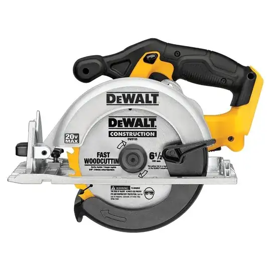

Take a look at this saw from https://www.lowes.com/pd/DEWALT-20-Volt-Max-6-1-2-in-Cordless-Circular-Saw-Brake/3962443
Dewalt Saw
It's a "cheapy", so don't expect a lot from it (it may also not be the right tool fro the job). But if you notice there are two and holds, and a blade guard. If used properly, you really can't hurt your self with this.
You use clamps to "hold" the wood, then with both hands on the saw, move it (the saw) to make the cut. With the blade guard in place you should have a pretty hard time hurting your self as long as you follow normal safety guidelines.

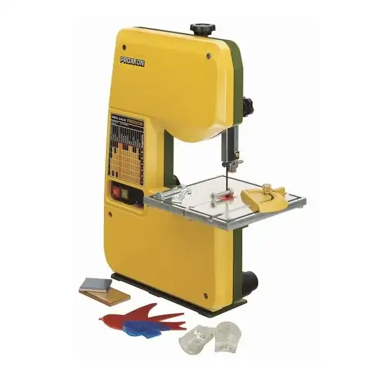

Band saw
With proper safety there all well and good, but as your finders usually are close to the blade, and with their ability to "snap" the band when used incorrectly, a lot of people get hurt with these. I would suggest not getting one of these types till you already know how to use them.

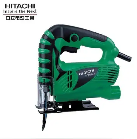

All that said, let me echo the recommendation for a jigsaw. Jigsaws are probably harder to accidentally mangle yourself with, and can handle just about any cutting task. The downside is that they can cut slowly, so there may not be much of an advantage over your manual saws if speed is what you're after.

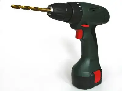

A power drill (battery or mains) with a suitable set of decent bits.
AND a power jigsaw, again with selection of fittings for cutting wood or metal.

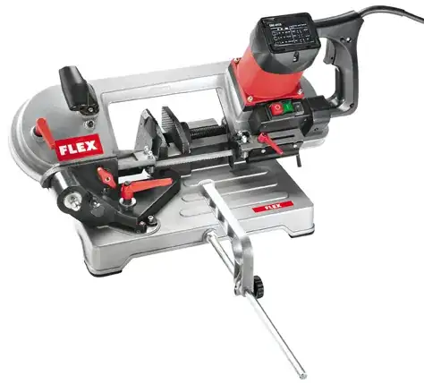

I was in exactly your situation; I actually liked to work with hand tools, and had self-imposed security constraints.
After turning more and more from wood to metal working, I got a bandsaw like this:
(source: flex-tools.com)
During operation you stand on the far side. The only thing you need to do is let one hand rest more or less lightly on the big handle to apply a modicum of downward pressure (the little, the better, as with all saws).
Like on some gardening power tools, there are defined places for both of your hands. At no point whatsoever do you need to touch anything remotely close to the moving parts. You do not ever need to apply any sort of pushing force to the machine, there is no way to slip off and ram a finger into the saw band. I must admit that I do not know what would happen if there were some catastrophic failure (i.e., the band snapping), but I would assume that it would simply stop going around. There can be no kick-back, the machine itself can not go jumping, etc.
The one drawback is severe limitations with the size of woods you can cut. Mine has a maximum opening of the jaws of 10cm, also the height of the workpiece is not limitless (like with vertical bandsaws). In a pinch, some (like this one) have a detachable main part so you can wield it without the table for making very, very rough cuts. Even in that mode, I'd regard it pretty secure, although it is pretty unwieldy (sic).
